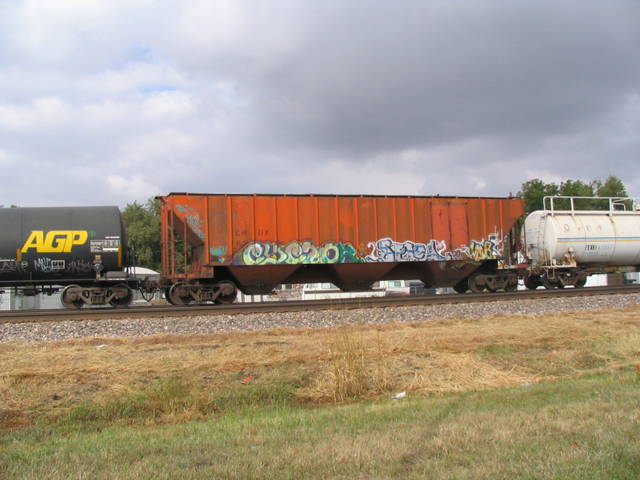

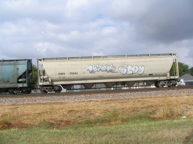

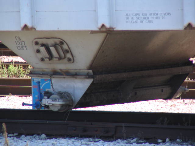

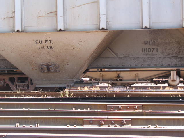

That’s a plastic pellet car or a resin car, not a grain car. Note the small round hatches on the roof. That screams plastic pellets. Note the narrow outlets with the tubes in them, that’s where they vac the plastic pellets out of the car. See the car right above the NAHX reporting marks? That’s a grain hopper. 3 bays. Large rectangular outlest, long trough hatches on the roof. Grain.
Dave H.
Grain hopper:
Not a grain hopper:
Grain hopper:
Not a grain hopper, not a grain hopper, not a grain hopper, not a grain hopper…
Grain hopper:
Not a grain hopper:
