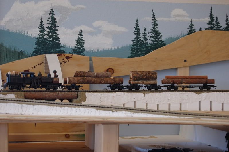

I started to model HO L-shaped layout which will feature continuous L-shaped oval, but will also have small logging spur, with switchback arrangement to gain height in limited space with no excessive inclines. In the bottom of logging area I plan to put siding to which logging spur connects.
I have unlettered Bachmann Shay as my logging motive power, and I have Rivarossi 2 truck Heisler on order, to complement Shay. Heisler is lettered “Northern Pacific”.
My goal is not to model some real operation with 99.9% accuracy, but I would like to have fair amount of reality on the layout.
