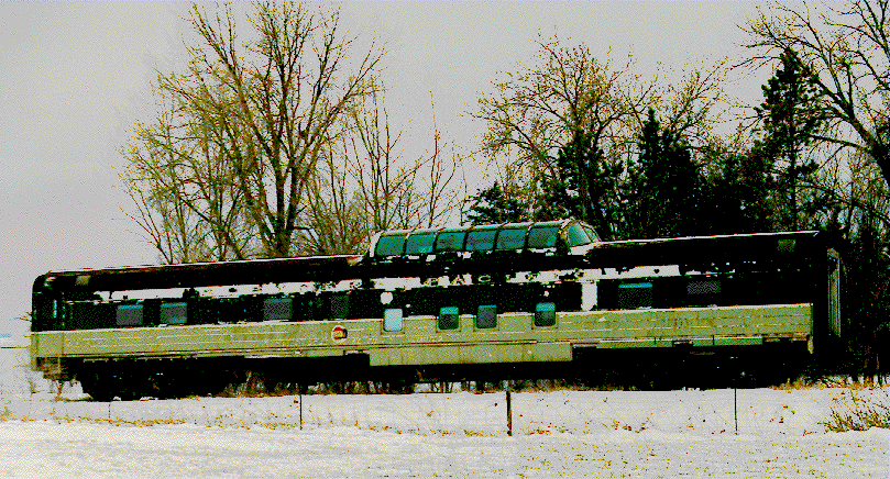

I think the hardest car to model will be the dome sleeper. It was unique to the NP. Several of them had the 4 rooms under the dome converted to a lunch counter in the 1967. I ran across car 610 in Madison Wisconsin in 1987. Tried like mad to figure out who owned it. By the time I did they had sold it to a fellow in Fargo where it still is today.
