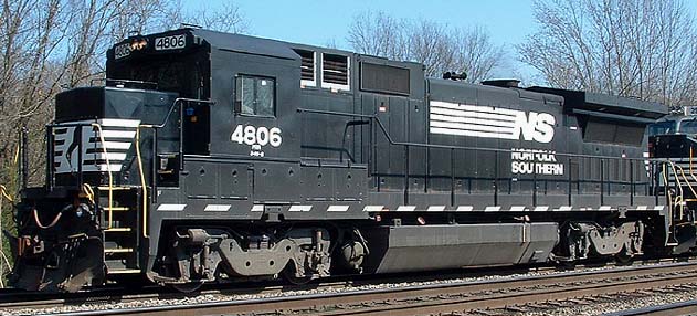

Can a Atlas 8-40B used with little effort to convert it into a 8-32B or will I need to shorten frames and body shells
http://www.nslocos.com/ns3522.jpg D8-32B (as NS calls the B32-8/Dash 8-32B)
http://www.trainweb.org/nslocomotives/ns4806.jpg B40-8 (as NS calls the Dash 8-40B)
It wouldn’t be easy.
There is no need to shorten the frame. believe it or not, the B32-8 used the same chassis length as the B23-7, and U23B. So use the cut down carbody, on the Athearn U-boat chassis. Don’t worry about wheelbase, if you were to cut a D40-8 chassis, you can handle moving the bolster, if needed. The carbody is correct, except for the six tall doors, instead of eight. Don’t get stuck-up on the Atlas drive, the Athearn drive will do.
