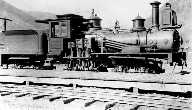

Cacole, I have a Spectrum, but the Silverton RR never had a three truck, just a two truck, this one:
The MDC isn’ t perfect, but it’s a lot closer than the Spectrum.
