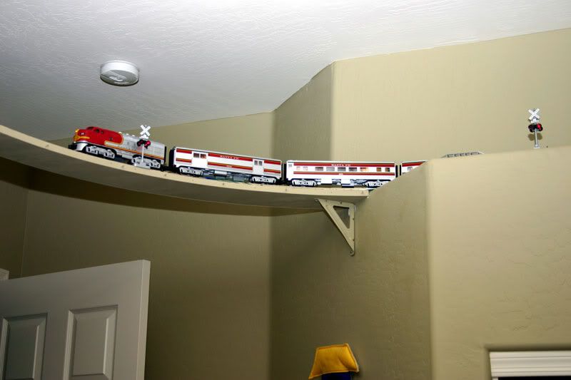

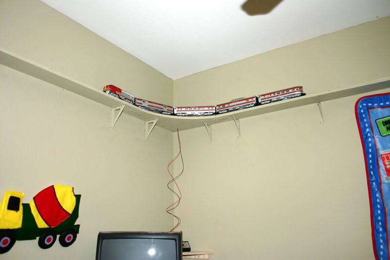

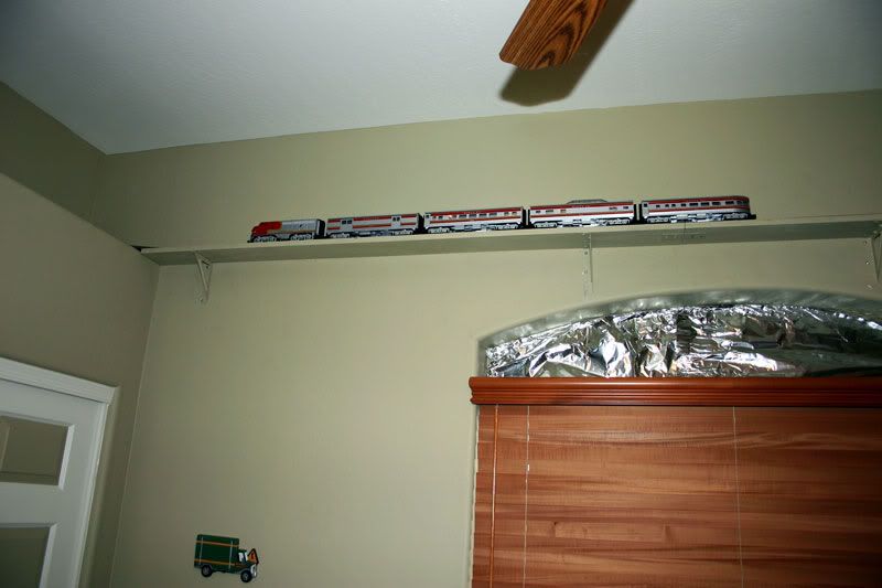

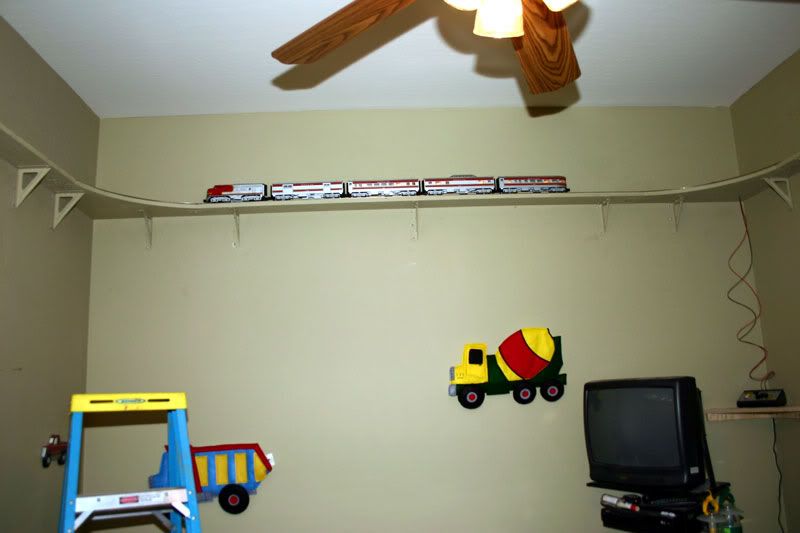

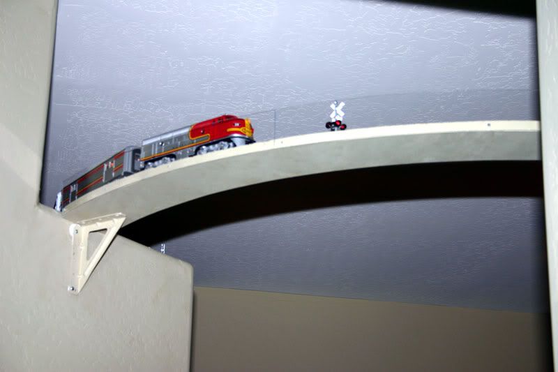

Thank you all for the replies … I appreciate it… well since I had the holiday vacation, I got it put up and done… I’ll post some pics as soons as I figure out how to… hahah
Ok figured it out hopefully…
Enjoy let me know what you think… A nice little train for my son to enjoy as he grows up =)
And thank you for all the replies and help… Made this project easier to do with it
Still have a couple paint touch ups and wiring to finalize but basically its done… Might add a little town on the planter shelf above his closet, even use it as a night light… have to figure out how to wire that separately though…
How wide is the shelf that the train is running on ?
Just over 5"… actually 5 1/8" to be exact…
