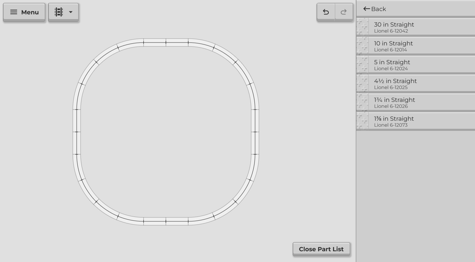

O60 Loop with two pieces of 10inch straight on each sid
Hey guys! I’m new here. I recently purchased a Lionel Legacy Mallet. It runs good, but is barely happy with my Atlas O54 curves. I look to expand my layout by a foot and a half at least if I can. How many feet long does your table need to be to fit a Lionel O60 loop with two pieces of 10 inch straight track on each side? I also have the same question for Atlas O63 with also the same amount of straight track on each side. How many feet long does My table need to be? I actually use fold up tables for my layout for the record. My layout is 5x7. I would like to expand it by 6x7 and a 1/2 to save some space conflicts. Thanks in advance.
Firstly, I’m presuming that by “two pieces of 10 inch straight track on each side” you mean something like this:

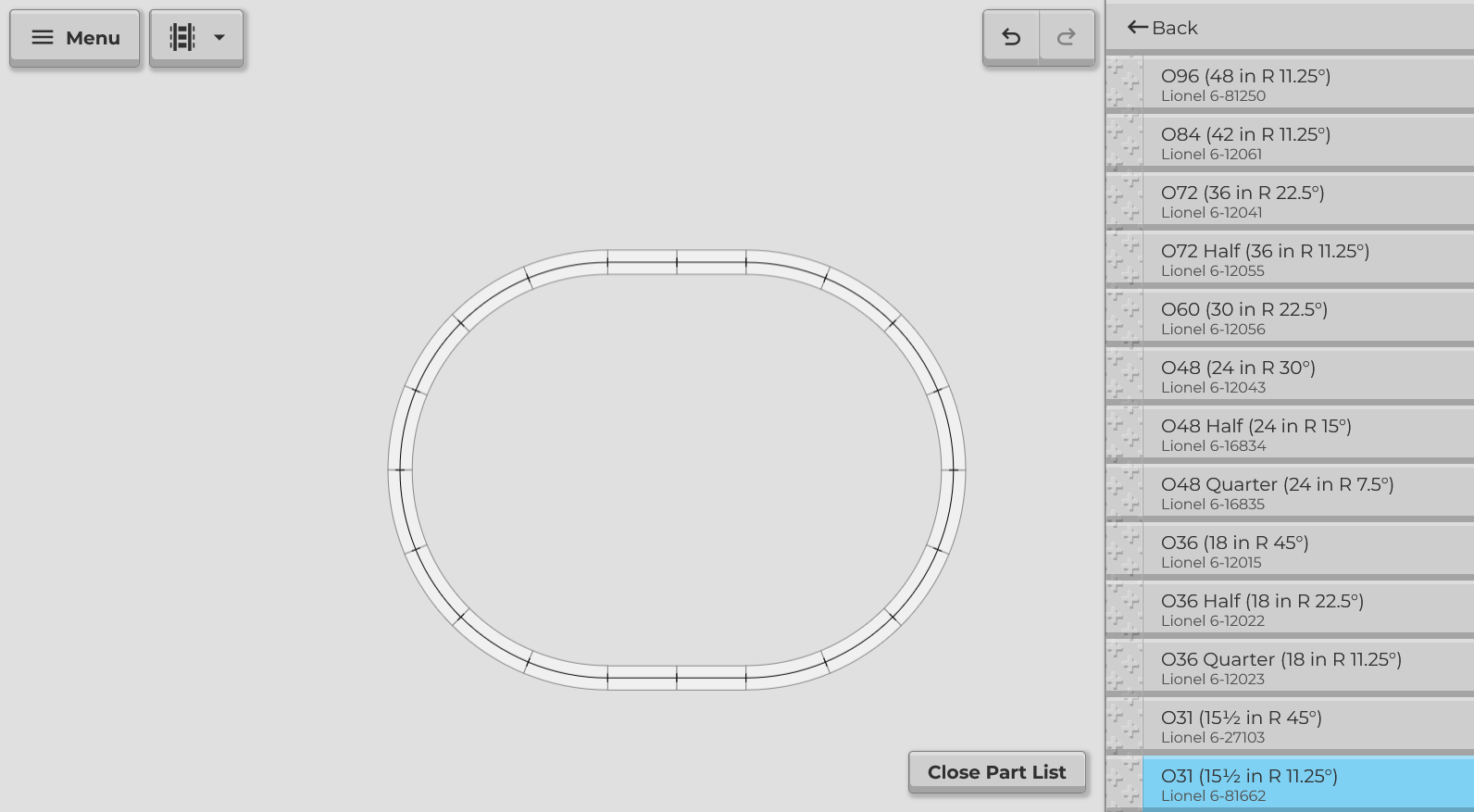

and not this, which will change things noticeably:
Well, track size is measured along the center rail. So for O60, you’d want to probably add a good two to three inches of clearance–but more is better, and having a nice gap between the edge of the track and the edge of a table helps prevent derailments from becoming expensive. So the minimum would be a 66x86 inch table. Which, of course, is an odd size, so you’d be better off with 6x8 feet–but 6x7.5, as you were planning, would also work quite well. For O63, you’ll want to have, as the minimum, more like 69x89 inches. A 6x8 foot table would fit that quite decently, but a 6x7.5 foot table would be a little tighter than I’d recommend, coming in a just 1 inch above the minimum!

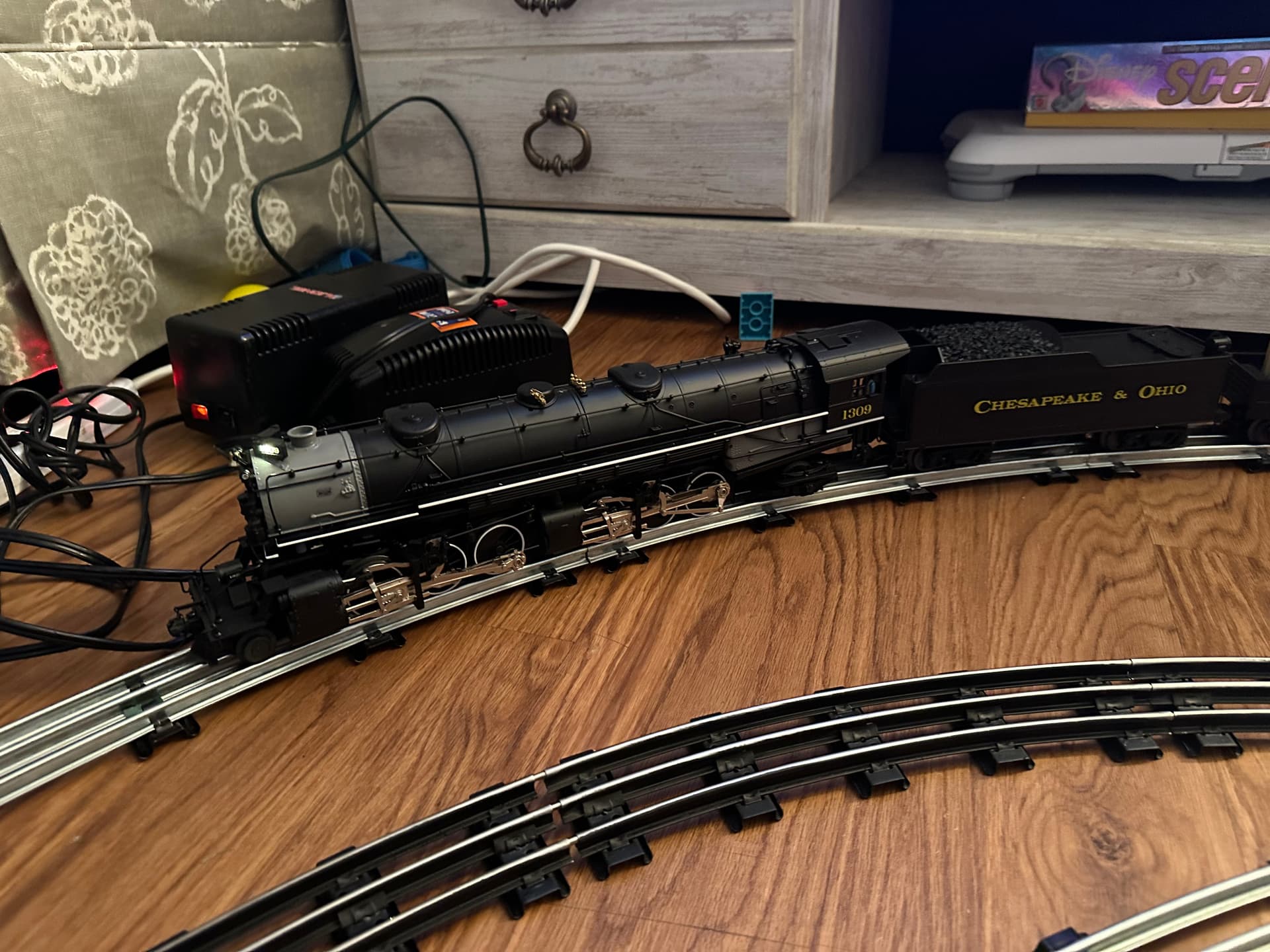

Assuming by “Legacy Mallet” you mean the USRA 2-6-6-2, that’s definitely on the smaller side of articulated locos(I have one in C&O 1309 trim) but really, find a way to do O72 if you can.

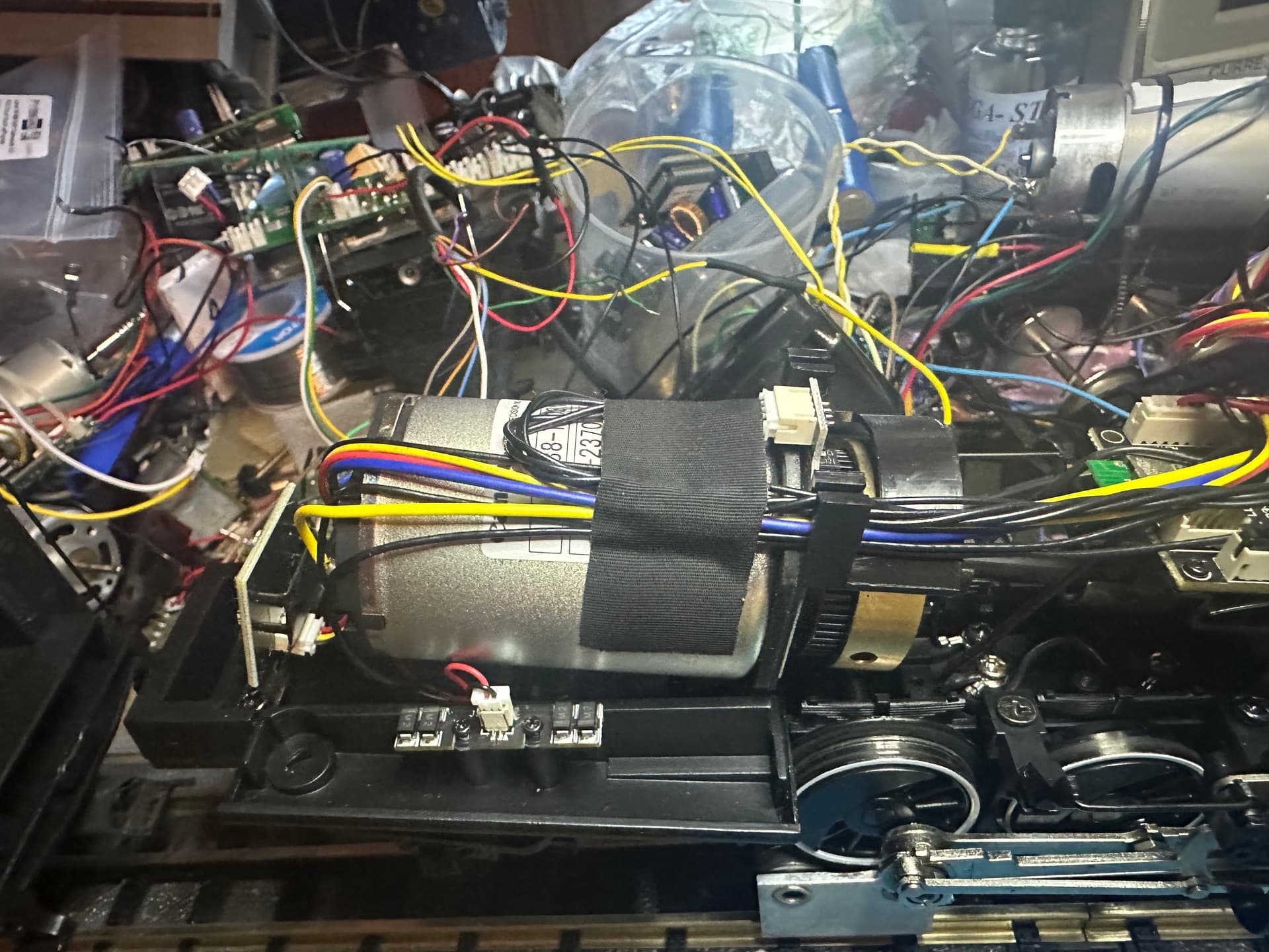

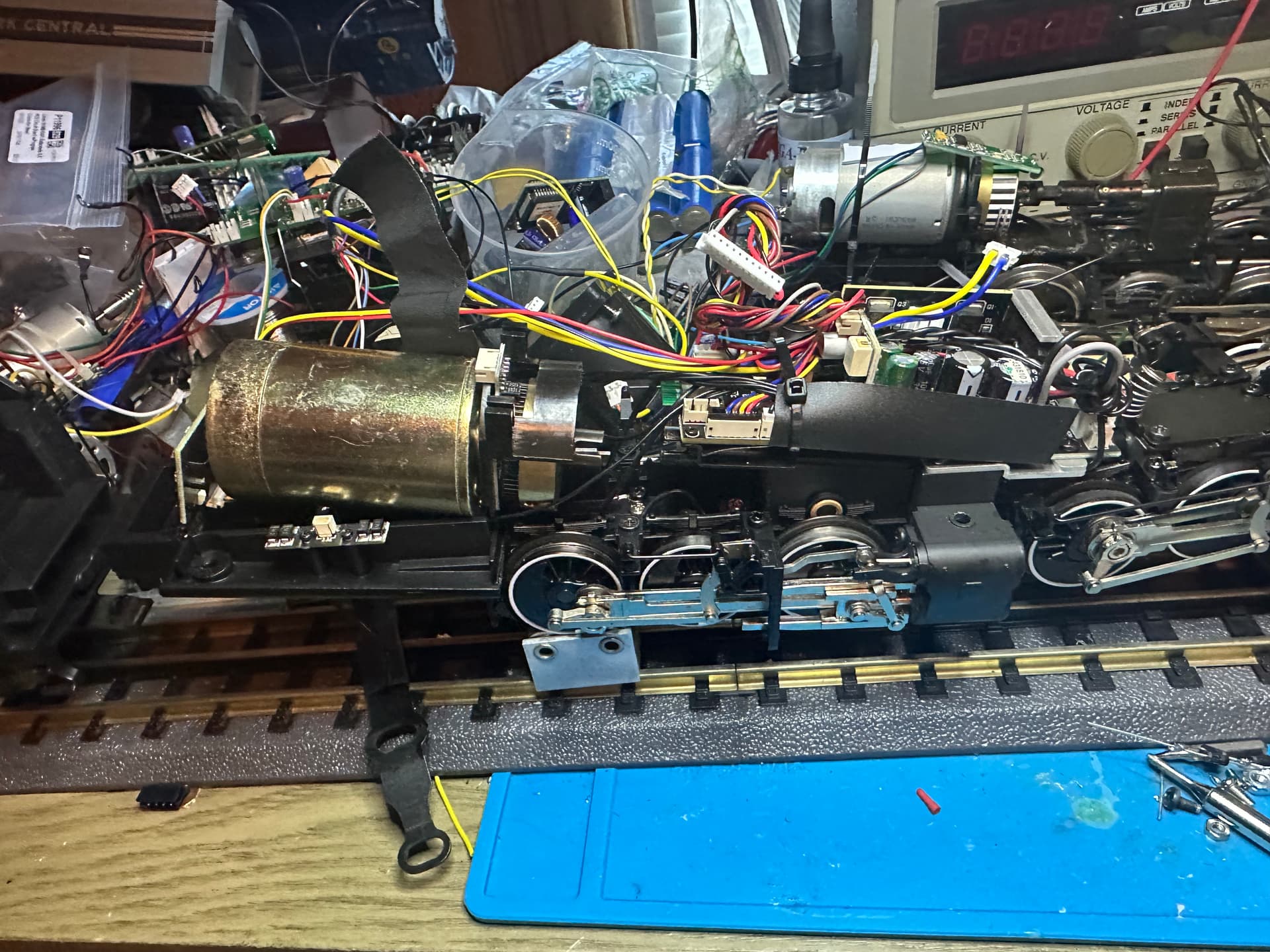

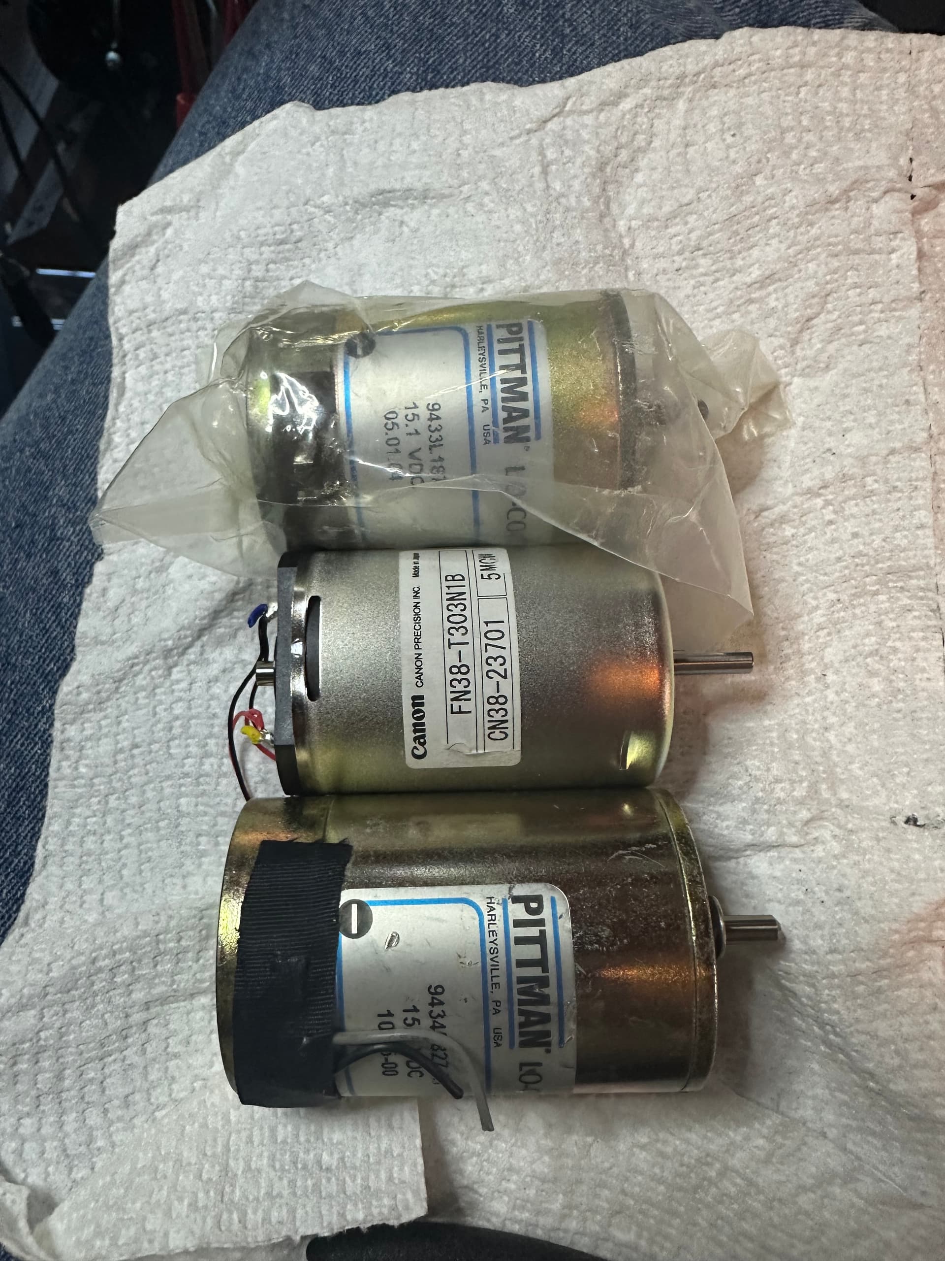

I love my USRA Mallet too, enough that I did this too it from my precious stash(and yes, it does run better)
