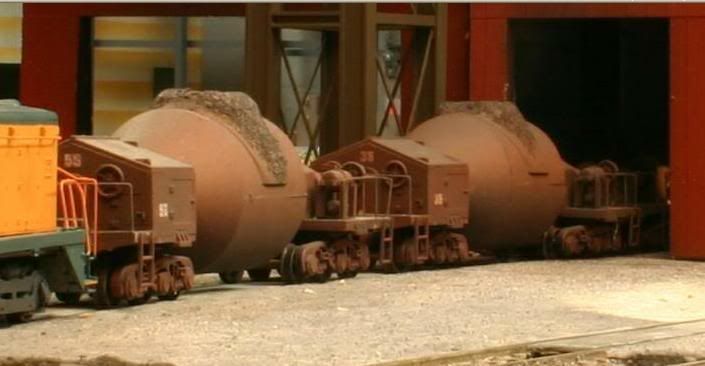

I’ve been using Atlas turnouts since the Dawn of Time and never noticed any major problems until now. My trouble occurs on a #4 in an industrial area, with a type of car that has 6-wheel Buckeye trucks [see photo below] - very unforgiving over uneven track.
I know I need to replace the turnout, it was damaged by a botched ballasting job I did on it ~ 7 years ago. Here’s my dilemma: Should I spend those few extra $$ on a more-reliable PECO #4 [DCC-friendly] t/o instead of another Atlas?

Is the Buckeye truck sprung and equalized? If not, if it solid like the Athearn truck, then it might be that a #4 is a bit of a challenge no matter who makes it.
