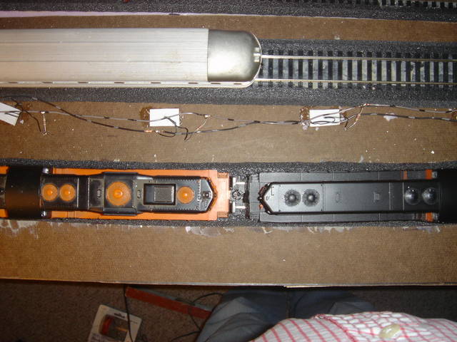

I’m really not sure how much track I have. I do know that I have enough feeders in on it now especially with the blocks installed. I have a 4x8 table with a 44"x60" table attached in an L fashion. Here’s a pic:
I have taken them apart to clean the wheels and the armature of the motor, but I’m not exactly sure what to inspect. I even cleaned out where the axles sit in the trucks. These are freightless loco’s running. Maybe they do need some lube and tweeking, I just need some pointers.
