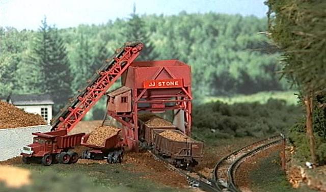

I actually delivered empty hoppers and gon to my gravel pit and loaded them with loose ballast. Of course, on a small layout with only a few cars…

I unload my hoppers at the coal dealer
Those mty hoppers goes to staging, from staging to harbor
and to other staging. In the fourth session the go to the coal dealer or other customers. An interchange e.g.
