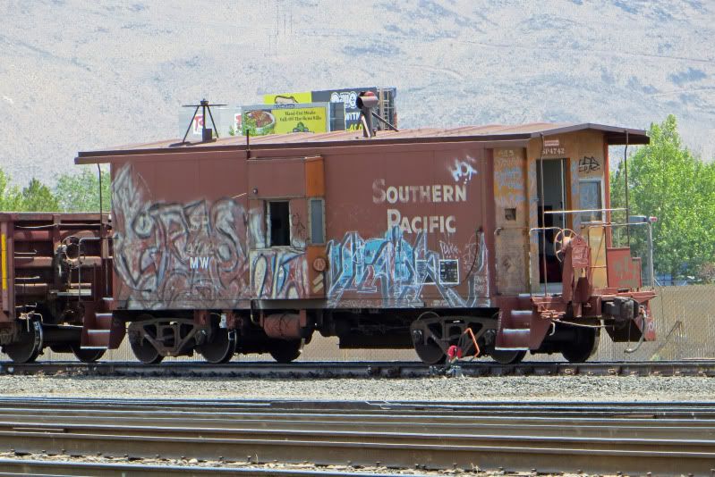

I came across this little gem in the UP Sparks NV freight yard, an old Southern Pacific caboose at the end of a small work train with several gondolas. I’m assuming it’s being used as a “kitchen” for the work crews? Is that a correct assumption? It’s a shame that it’s been covered with graffiti.
It might be in use as a rolling kitchen, but I suspect it’s in use as a “shoving platform”, or a place for a crewman to ride during local switch jobs. I occasionally see an old CSX caboose here in Richmond being used for that same purpose. Sadly, it’s got equal amounts of rust and graffiti all over it.
Note the MoW marking on the left, educated guess is it’s a shoving platform, mobile office, break room and even used as a real caboose when the train is moved to keep an eye on any equipment on flats that go with it, might even carry a few workers on short moves.
Kinda a camp car/office all in one.
Hey, at least it is still in service!

If a work train assigned to a general modification/improvement/repair job lacks a cab’ for a crew member on the train’s other end (from the eng.) imagine a railroad with no tolerance for “blind shoves,” in other words you the engr needs info from a crew member to change direction and move the other end of your ribbon-rail 1/4 mile long train back … 'cause guess: the track guy and you the engr got stopped too late and you need the highly limited slack’s advantages to get the train started.
If no one is back there, the portion of the project using this work-trains obligation’s would wait upon the employee on the ground walking back (at 15 minutes per train length and then back) That’s an hour, walking and working that an emloyee in a caboose with a radio could save.
engr to condr…(radio/cellphone/tweet…) need to back a coup’ la cars.
condr to engr…I’ll call you when I get to the rear end. (it’s 40 cars away)
3/4 mile walking back and then to the head-end. after the move. How many MOW employes, ballast regulaters, tampers enjoy the intermission during the hike?
A caboose and a brakeman saves how much?
Haven’t seen it written but,every work-train condr makes sure that the only signals, audio or visual, that his engr takes, except “stop,” comes from a crew-member.
