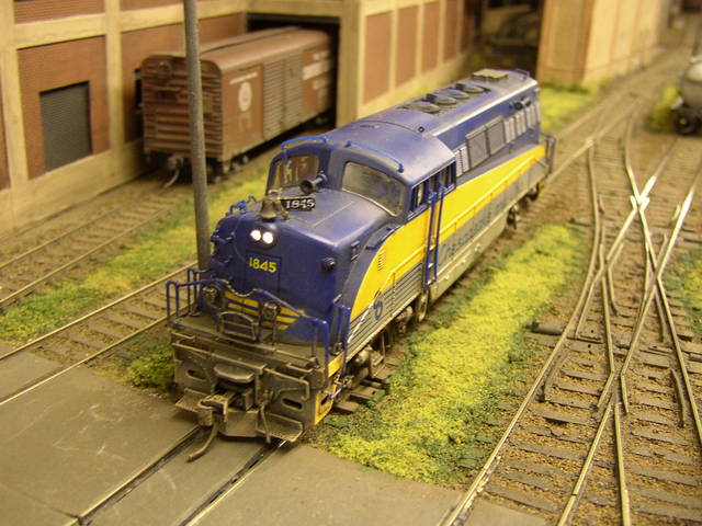

Nice looking Monon BL2s. I also have one on the way.

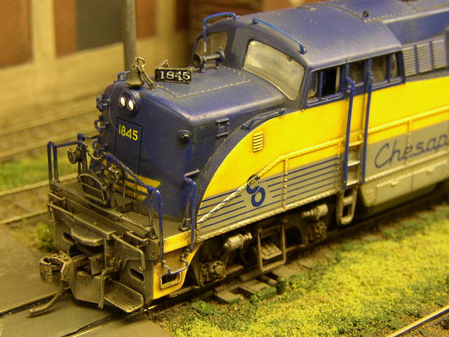

I replaced the bulb with a white LED in my C&O BL2, at the same time I fitted the soundchip. It should work with DC as well.

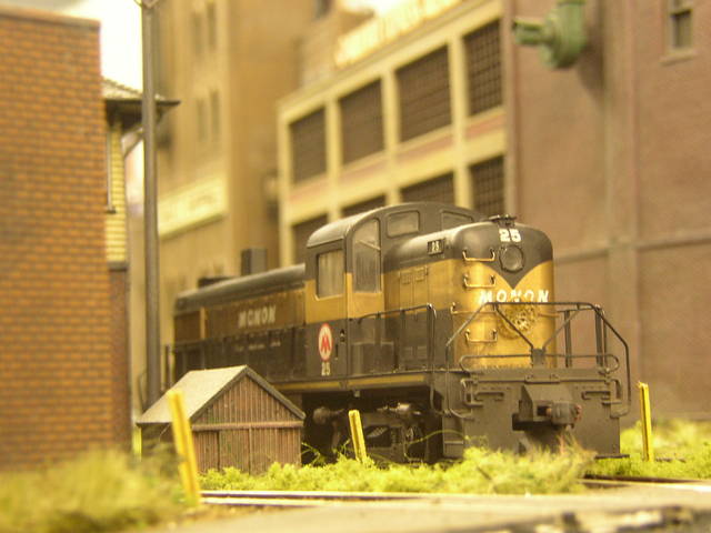

I got mine from Timonium, or rather a pal picked one up for me after I asked him to look out for one. I’m quite partial to the black/gold scheme, but only have a Proto 1000 RS2 at present and I know what you mean about the gold catching the light.

Is that a BL-2 specific sound chip? How do you like it? I wouldn’t mind having one in my BL-2 as well. What brand did you buy? I have bought several Proto’s, as well as having all of the original AHM versions ( I like BL-2’s A LOT ). I found out that if you drill holes in the old shells over the gas? door casting, a small round dot in the middle, you can use the old AHM bodies on the Proto with no problem. That way you can have more selection of railroads, from FEC to BAR to CE&I. I don’t think Proto had any of those roadnames on their shells. Just a heads-up.

I like what you did to your C&O BL2. What did you do to fill in the numberboards? What paint did you use to cover it up?
Is the headlight a standard bulb or an LED beam?
