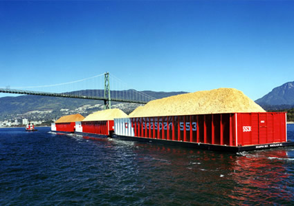

Modeling sawmills, pulpmills and a long list of others is popular on the West Coast as this is what we grow up with. The best sawdust is made with tile grout and it comes in the perfect colours aleady.
Sawdust/woodchips leaving Vancouver probably came off rail cars and is on its way to the pulp/paper mill.
Seaspan Marine - Forest Products - Seaspan
