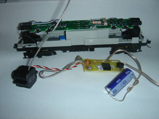

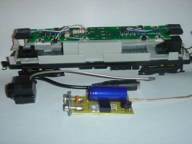

I have one in the front of one of my subway trains. I started with a camera from SJT Enterprises, and one of their DCC power modules. This camera outputs RF, which is received by a box which converts it to an old analog TV signal. This is the original camera, power supply and the car it needed to go into.
The power supply was too big, and it also required a huge plug-and-jack assembly to get power from the board to the camera. I contacted the manufacturer, and he was happy to modify the connection and the power supply card for the princely sum of $15.
With a small amount of modification to the car’s light board, this fit neatly inside.
The interior of the subway car is confined, and I needed to disconnect the interior light at the front end of the car. The extra heat was causing non-permanent degradation of the video image from the CCD camera. Also, the tunnels are dark, so the large holes in the front of the car were filled with big LEDs to add light ahead of the train.
