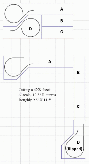

Hollow-core doors seem to work well in this situation. There are more different sizes than I realized when I first started looking at them, including narrower bi-fold closet doors that can be handy. Although the image below would be a little large for your space, it shows how cutting the 4X8 sheet can yield a nice N scale layout tucked against a wall in a corner. The minimum radius of about 12.5" might also be a little tight for modern equipment or the big steam that’s coming out in N scale.
