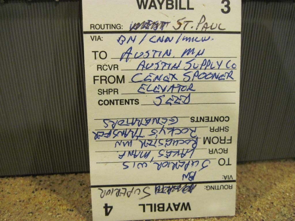

That’s exactly what I’m saying, with the exception that some waybills will have an "on layout " destination in one of the 4 spots. When the waybill hits #4 I remove it, put it at the back of the waybill box and send the empty car to where ever the home road is. The car is pulled from the layout till its turn comes back up, a new waybill is chosen from the appropriate box and off it goes for a new 4 cycle round.
I can post a couple pics of waybills if you want.
Terry in NW Wisconsin
That would be great!
I basically understand the Car Card and Waybill concept.
Here’s one of the originals. This is where the PITA came in, trying to come up with shippers, loads, receivers, etc.
Compared to this. I left room for that stuff if I ran out of other things to do.
Hope that helps
