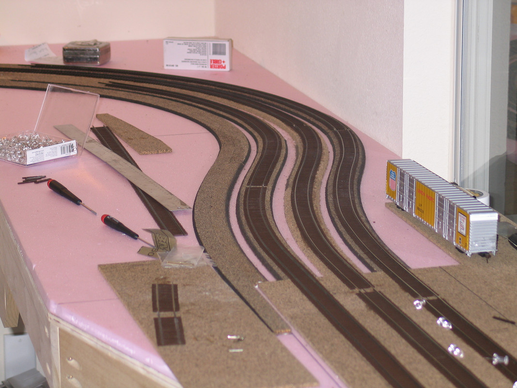

This photo is from my first layout. I decided to go with the ME flex because I liked the way it looked compared to the Atlas flex. Working with one piece to understand what it takes to create smooth flowing curves gave me the results in the photo.
