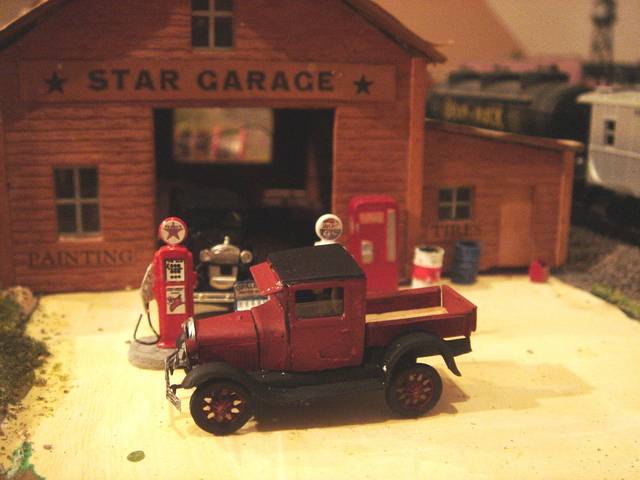

This is a photo-tutorial done by Bob Grech. It’s an excellent step-by-step guide to painting and assembling one Jordan vehicle.
http://www.trains.com/TRC/CS/forums/807093/ShowPost.aspx
I printed this up and went through it while building this one, which happens to be the same kit Bob used:
I think the biggest hurdle was getting over the fear of the tiny parts and the unfamiliarity with building kits of this type. Yes, I put stuff together with tweezers. Some of the parts are that tiny, but it was an interesting experiment. (I’ve got another one going now, by the way. The first step was some spray painting, and I haven’t gotten back to it yet.)
I probably spent 2-3 hours on this one, not counting the drying time for the paint before and during assembly. The next one won’t take as long. I “customized” mine by adding a driver, who needed some body parts removed to fit him into the cab. By the way, things like the gearshift and handbrake levers are so small that you can’t really even see them inside the cab. I put them in, but realized that no one would ever have known if I’d left them out.
