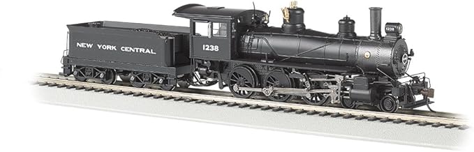

Bachmann standard:
Bachmann Spectrum:
Model in question:
note that the standard line has molded on piping, whereas the spectrum lines all have separate piping. The $65 model is a spectrum, although it is the default undecorated engine, with added decals.
