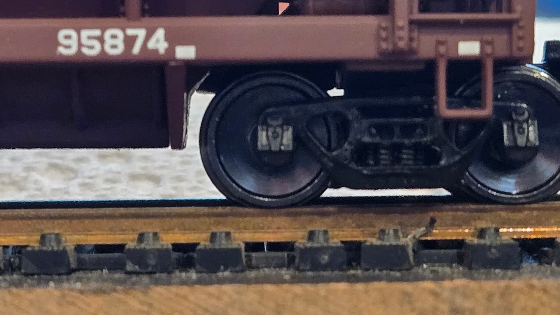

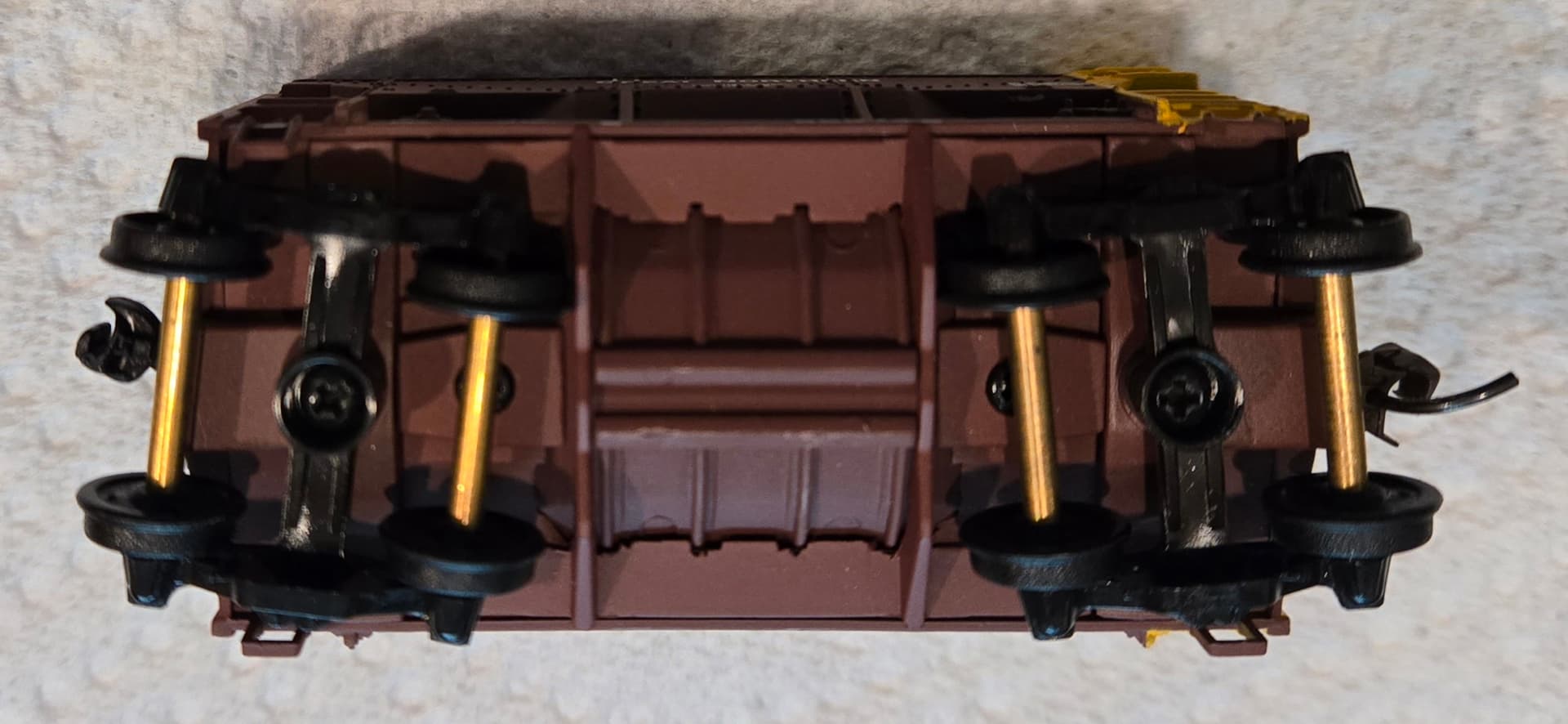

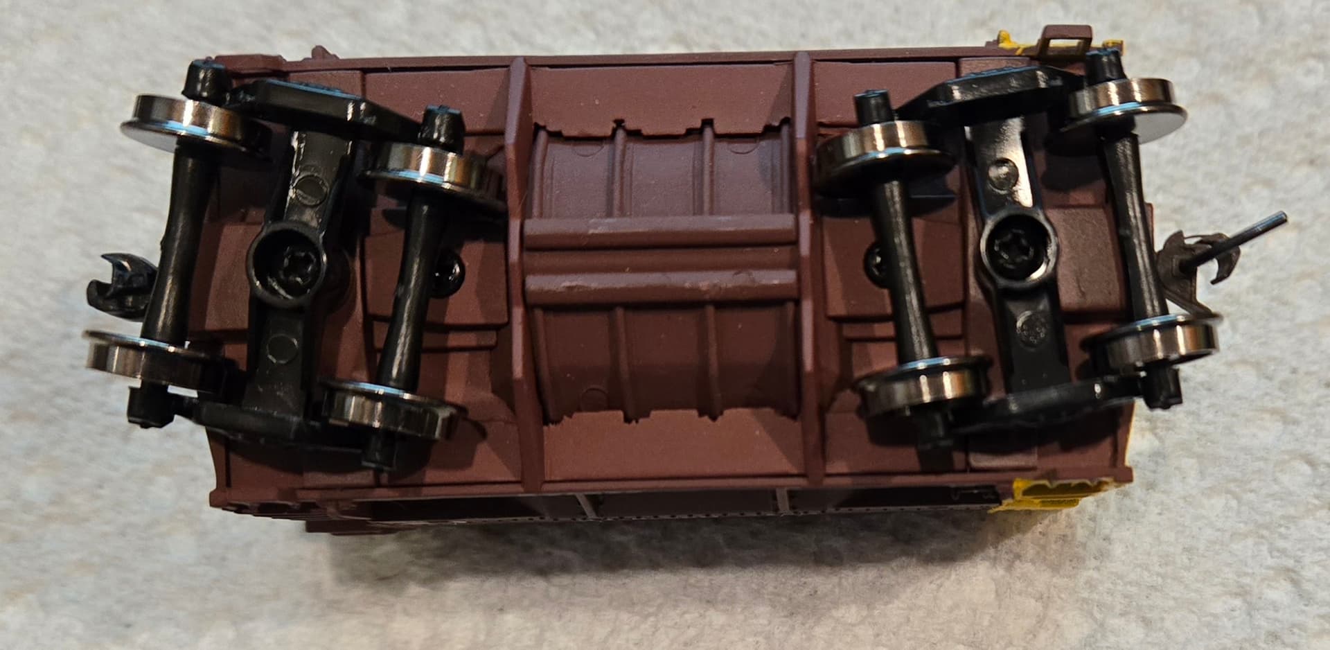

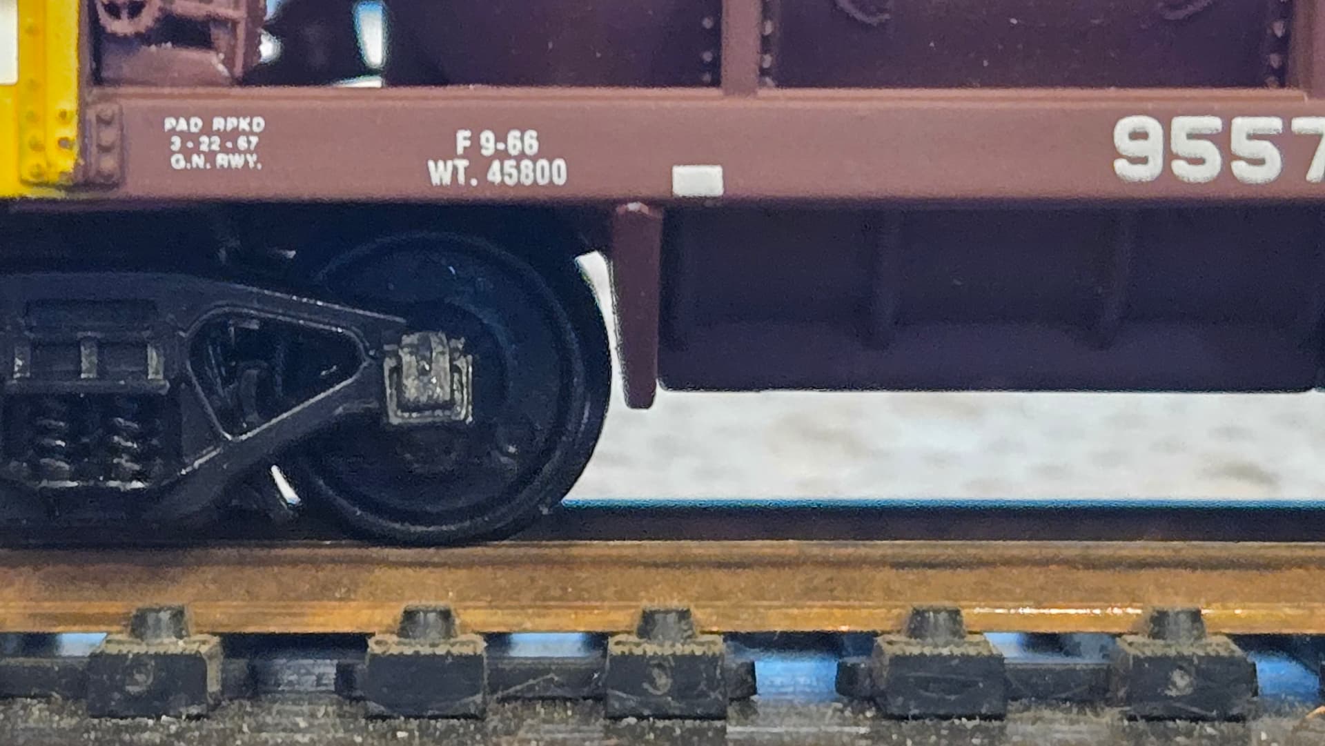

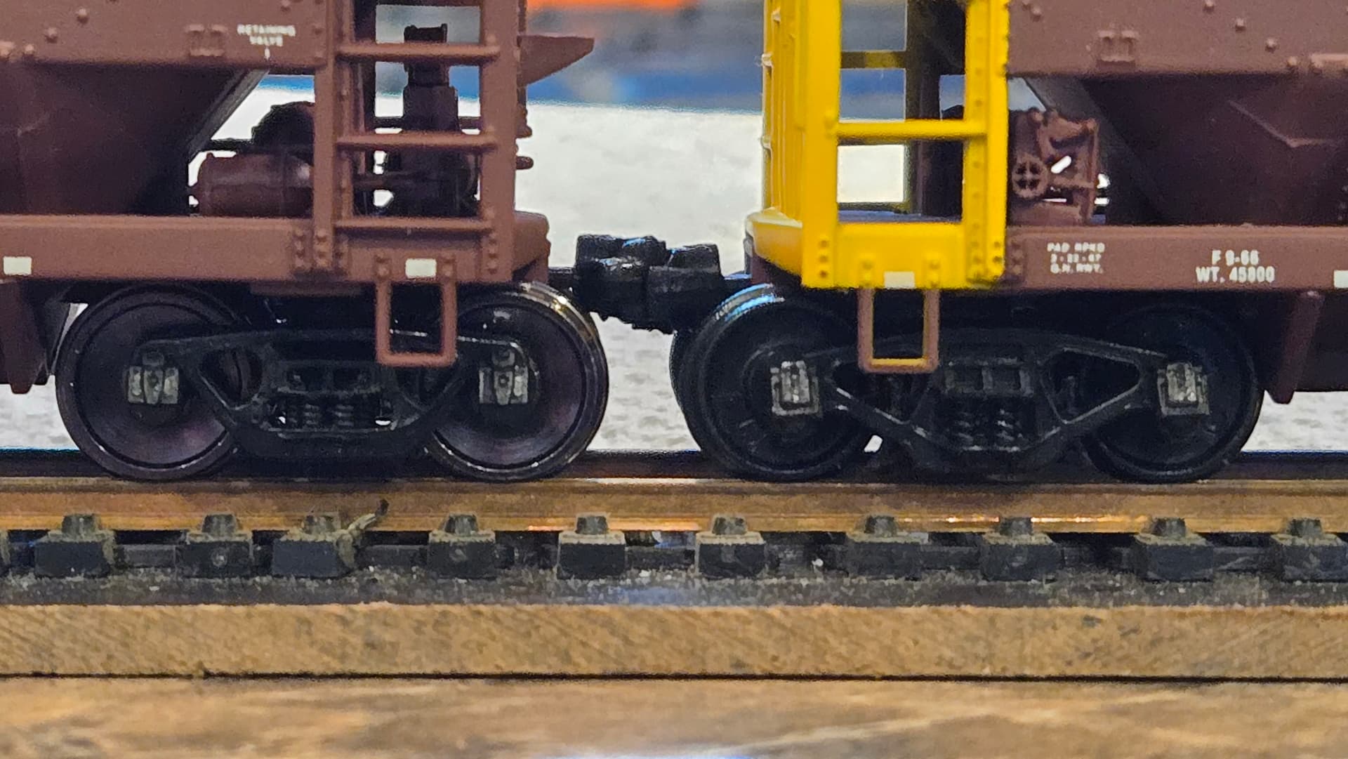

Modeling the DM&IR, nautrally ore cars are a large part of my fleet. The Walthers Goldline cars are great, usually no problems there. Problems are two fold, starting with the Walthers non Goldline cars (plastic wheels). Since ore cars are at a premium, I can’t just pick up only goldline sets, I have to take whatever I can get. I had planned on replacing all the plastic wheels in these sets with metal wheels, figured it would be straight forward. Not even close. All the wheels I tried adding rub annoyingly on the car, and some even restrict its operation. Why do the Goldline cars not rub (or not much) but merely adding wheels to these will cause it? Does anyone know of trucks or wheels that will not rub? I don’t really want to take the time to file down every single ore car frame in 4 spots to try and alleviate it.

The ones I tried were Intermountain 33’ and they rubbed awful against the car.

The Walthers ore cars need a short wheelbase truck to run without rubbing. This is what I believe will solve your problem: https://www.walthers.com/rigid-trucks-w-33-quot-metal-wheels-axles-5-wheelbase-for-ore-cars-1-pair
If you use standard wheelbase trucks, the close clearances under the ore cars will cause the wheels to rub, as you’ve noted. By bringing the axles closer together, these eliminate the rubbing.
IIRC, the MDC cars don’t need this as they were designed with plenty of (non-prototypical) clearance for the trucks to swing. It’s been a long time since I had any of these in hand, so maybe someone else can suggest a suitable truck they know will fit?
I recently built up a DM&IR ore train, which I built with all Walthers cars. I swapped in the correct short-wheelbase truck frames and bought several bulk packs of Intermountain 33" wheels. There were a handful of cars that had some squeaking from the wheels rubbing against the bottom of the cars, which I fixed by adding gray Kadee washers to the offending trucks, which was enough to get rid of any noise without affecting coupling.

No, the issue is limited clearance for truck swing because Walthers built them to use prototypically correct short wheelbase trucks. Standard wheelbase trucks put the wheels where they tend cause the rubbing that folks complain about.
Raising the body of the car with a washer will gain you the needed clearance, but will also raise the coupler mounting height. If you’re consistent, you can make this work on your layout, but it may cause compatibility issues with other rolling stock because of the non-standard couple height.
I don’t think the truck length is really the problem. I mostly suggest swapping the truck sideframes because the cars look better that way. Yes, the longer unprototypical trucks had a very limited swing, but with such short cars you need to have tight curves before that becomes an issue. In my experience it was a purely vertical clearance issue. A single washer, especially the gray washer, won’t change the height enough to cause trouble.
One note about coupler height, though, is that I found that some of the first run of the ore cars had an issue with the underframe where the coupler pocket wouldn’t sit flush. I did have to attack that with a file to get the couplers to not dangle low. It’s hard to describe the change, but if you compare with one of the newer cars you can see the difference.

Sorry if I wasn’t clear enough. Problem isnt the wheels persay, rather they rub on the bottom of the car where the dump doors are located. I haven’t noticed much of a problem on the Goldline cars,but when I added metal wheels to the regular line cars they rubbed bad. Goldline comes with metal, regular does not. I went ahead and purchased some walthers ore car trucks from the website and hopefully those will be able to help this problem. I will try the kadee washer trick and see if that helps too.

For the Walthers cars, I went ahead and purchased the special short ore car trucks, and with 33 intermountain wheels it seems to have done the trick! No more rubbing! Now to clean their stock out…
