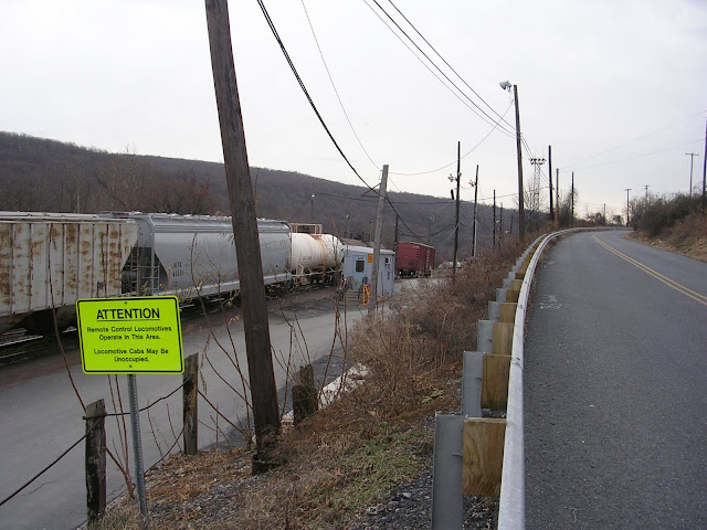

Carl’s reply above about the length of the receiving or hump lead tracks being the governing constraint is of course correct. Such tracks are usually flat or nearly so; if they’re on any kind of a grade, that and the resulting tractive effort needed to push the cut along them will govern instead. The usually short and steep grade up to the hump itself won’t govern - there’s not enough cars or weight on it at one time to seriously impede the hump pusher engine. For example, here’s a zoomed-in photo* of our local NS Allentown hump approach - you can see that there’s only about 10 to 12 cars on the slope at a time:
[IMG]http://lh5.ggpht.com/_o57bVHrFAbQ/S5_i81meucI/AAAAAAAAAeA/rX_0gUqIAnY/s6

And “my” yard is unique (as far as I know) in the country with its method of operation. We may be the only practitioners of the art of Car Retarder Operating left. A few people who read this Forum have been lucky enough to see where I work; even fewer have actually been able to watch us perform. At times it seems like nothing is going on, but the actual volume of activity would make one’s head spin.
One might be better served by going to a place like the Golden Spike Tower in North Platte, armed with a scanner. The docents up on the observation level are often retired employees who could give one a good idea of what’s happening, when, and where (but they might be annoyed with the scanner!).
Paul, for the record our hump leads are on a long, sloping ascent to the top–most of the shove is on this gentle grade at any given time.
Just noting that I finally inserted my photos in the post above.

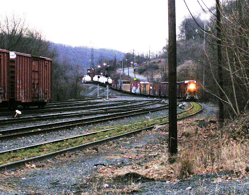

A couple closer-up photos of the Allentown Hump, to whet your appetitie, Carl - one from yesterday in the 60’s, and one from Jan. 10, 2008 in the 30’s
