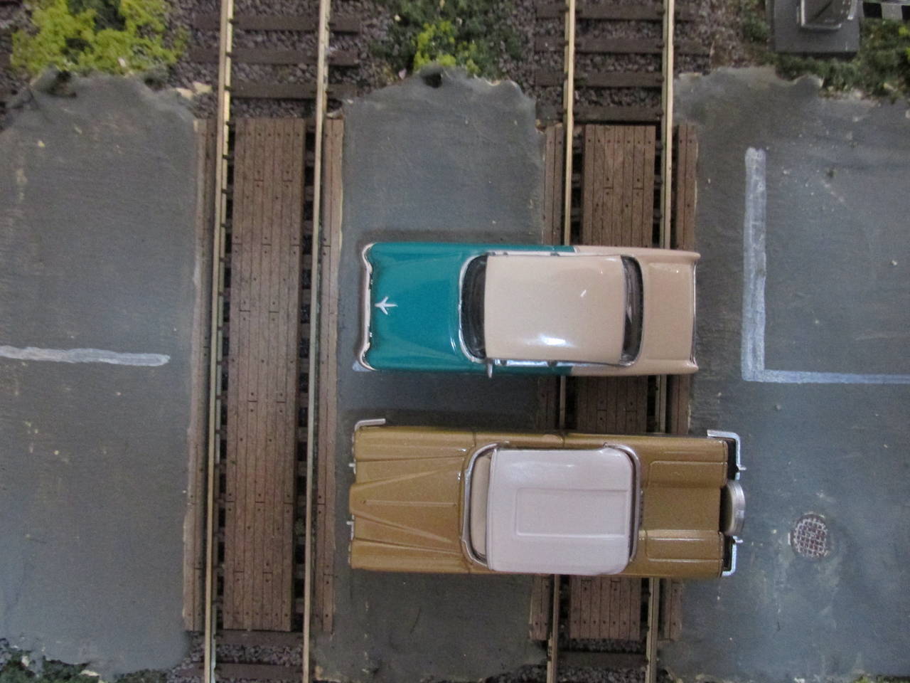

I’ve got the 49 Mercury’s, Lincolns and Edsels. The Lincolns look right, but the Mercury’s and Edsels look a little big.
I agree with Santa Fe all the way!
I compared an Oxford '58 Edsel to a CMW '55 Chev Belair and the Edsel is larger, but nothing too extreme. I wouldn’t put them side by side in a parking lot. However, if you put the Edsel beside a Busch Buick for example, there is a noticeable difference. The Busch Buick is about 1/4" shorter where it should be close to the same size. I think Busch looks to be the furthest off the mark. I measured a CMW '55 Chevy a few months ago and IIRC it was almost exactly to HO scale. IMHO the Busch vehicles are only good for background scenes.

I picked up my Edsel and T-bird today.
The Edsel is indeed longer than the 55 Chevy Belair, but I looked up the specs for both vehicles and they seem to be pretty close to the right proportions.
The Edsel was 21 inches longer and 5 inches wider than the Belair. I’m not sure if the measurement included the bumper extension to hold the spare.

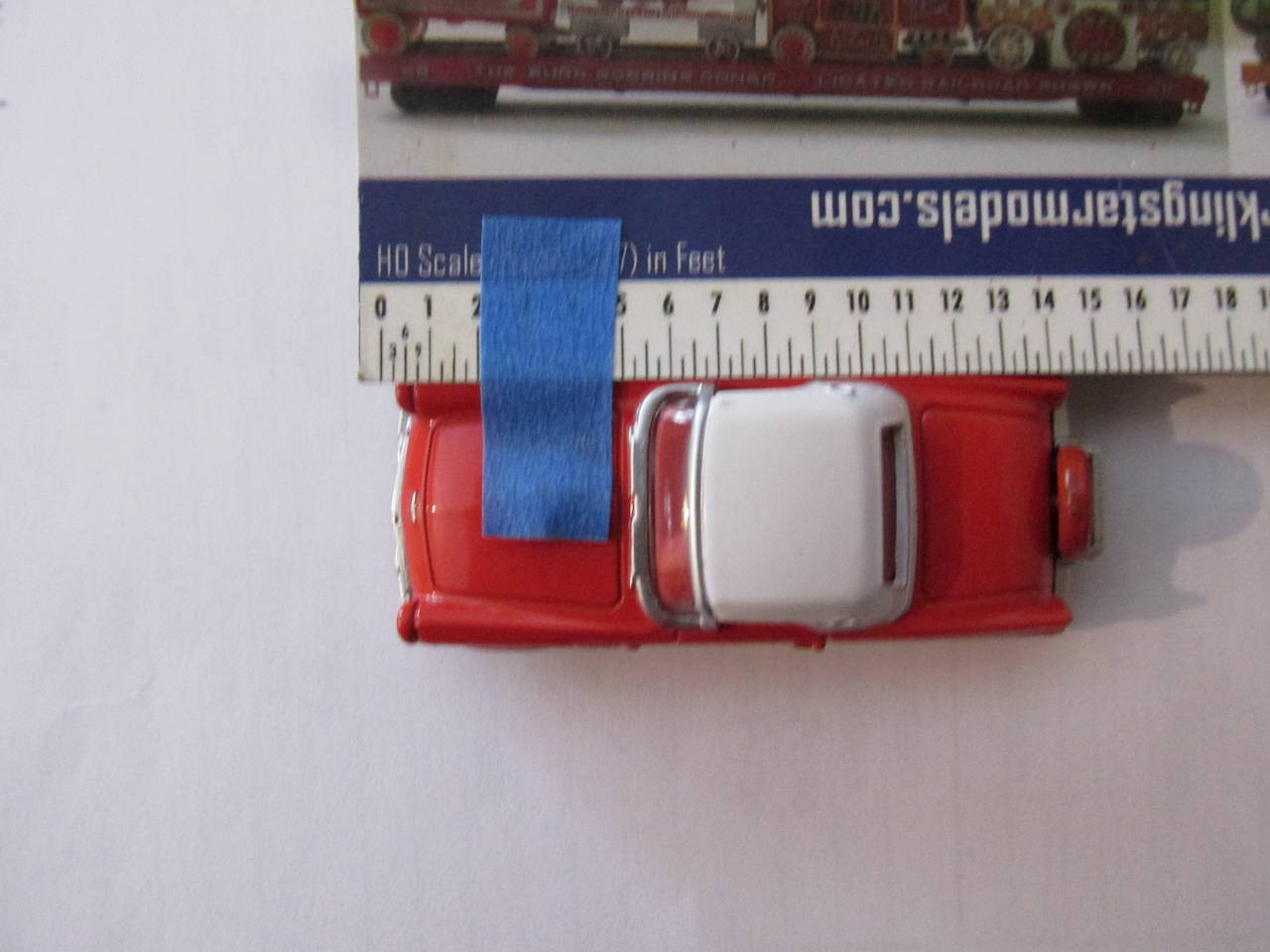

OK, I was lazy, and my workbench is a mess and I couldn’t find my scale ruler.
The spec on the 1958 Edsel is 18.2 scale feet long. This looks pretty close to me. I don’t know if they include bumper extensions for the spare like this Edsel has in the spect, but if not, then the model would be too short, not too long as some have claimed. The T-Bird is also pretty close:
EDIT: I apologize to those who saw the first set of pictures. It’s trickier than I thought to get this picture. I had to tape the ruler to the top of the car. Putting it on the table with the car on top of it caused angular distortion from the close-up camera angle that added a foot or more to the apparant measurement.
