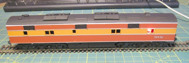

Model Power shell on Athearn SD40-2 Frame.
I like the Model Power E7 shells because they are really easy to modify and they fit any E7 frame.
