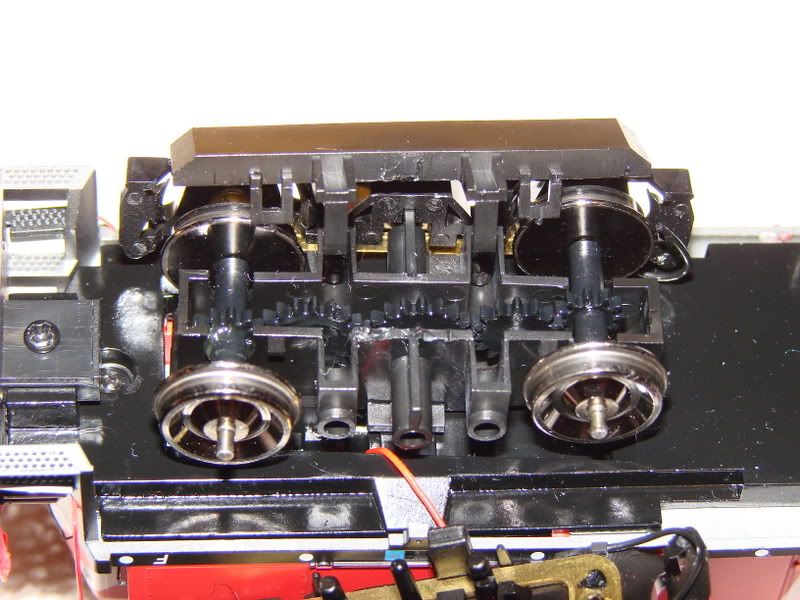

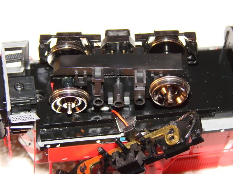

OK Jeffery, this is what you do…
1st slightly lift up on the cover so the sides of the truck can pop off.
Now that the sides of the trucks are removed you can now see the little tabs holding the cover on. Slightly pry open the tabs doing one side at a time and the cover should pop off.
Thanks. That’s just what I needed.
Cool, it gave me a chance to use that Macro feature on my camera that everybody was talking about, lol. .
Well, wadda ya know - those things don’t even HAVE any bronze bushings on the axles !!! Slippery plastic against slippery plastic !!!

Mark, thats factory Proto gunk, lol. Don’t worry, after I pulled the cover off I thought the same thing. [censored]
