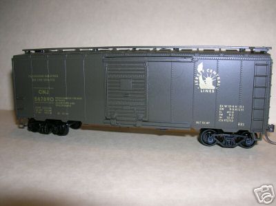

On many of the post 1990s models, which have a much thinner layer of factory paint than model railroad locomotives/cars produced in previous decades, it’s possible to get good paint results on prepainted vehicles in some limited scenarios. For example, if you have a unit that is in a neutral color and has small silk screen logos and lettering then cleaning, prepping, and painting can be a snap. Here are a few “paintable” examples:

http://www.homauchchunk.co.uk/Athearn-BL%2040'%20Boxcar%20JERSEY%20CENTRAL%20LINES%20-%20CNJ.jpg
Normally I prefer and recommend paint stripping, but with experimentation I have successfully painted over factory finishes. Again, key factors that help the most are: Neutral color and small lettering and logos.

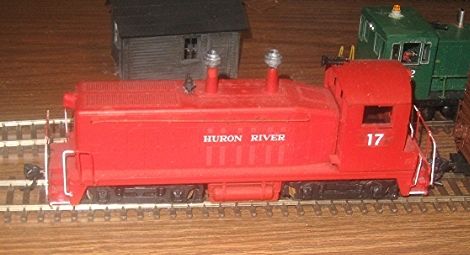

Here’s a Athearn SP SW7 I simply painted over so,yes it can be done.
