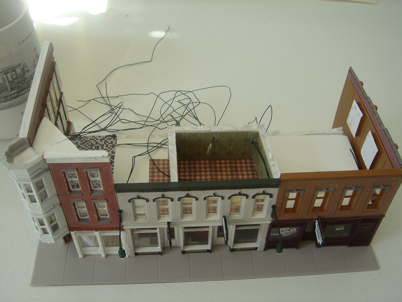

This is the front face of my Walthers Merchants Row kit:
I sprayed several different colors to get the multiple-building effect. The left is a Krylon rust primer, the center is a cream-color, and the right is the natural brown of the plastic the kit was molded in. When I sprayed the cream color, I did it from a low angle. Somehow, I lucked out and the paint only ended up on the bricks, so I didn’t have to mortar that section. I did the rest with a light gray was of acrylic paint, flowed into the mortar lines and wiped off the surface.
