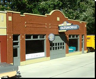

Thanks for the tips. I will take my time and do it right. I picked the Oldsmobile Dealer because it is a building right out of my old home town of Lockport, Illinois. As soon as I saw the building on his web site I recognized it and wanted to add it to my layout. I am only using the front. I will build my own side and rear walls and a roof. I’ll post a picture of it as I progress. It is going to take me a while though. I definetaly want a realistic look.
Oldsmobile Dealer
