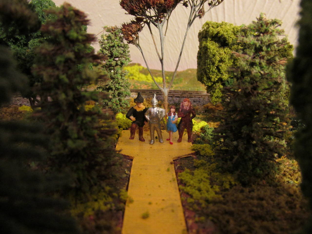

Kept them on the sprue while cleaning up the mold lines and flash, (which I should have done a better job at). Then gave em’ a light airbrush coat of sand colored paint. Makes for a nice primer/base coat for the brush on paint, and also saved a lot of hand painting of the flesh areas. In retrospect I think a light India ink wash would give them more depth.
