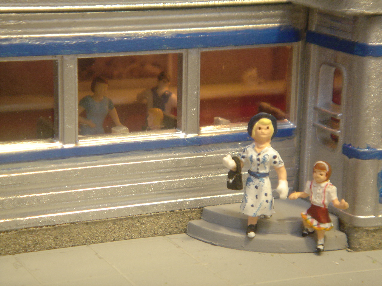

Maybe I should paint over this Woodland Scenics lady? Jeepers, creepers, where’d you get those eyes?
A very light touch of dark weathering powder will also bring out details, and darken the complexion of figures you’ve painted with “flesh” tone paint, which is quite fair in complexion.
Little Orphan Annie all grown up and with a kid of her own…
I’m not sure that the Woodland Scenics figures have enough molded facial details to get away with the standard paint & wash method of accentuating figures. I don’t own any (“Man no longer Free - Man get Pricey” - Crow T. Robot), but unlike Presier, Model Power [!], New Bachmann (not the 1960s Plasticville stuff), et. al, it doesn’t look like a lot of definition there (sort of like the old Plasticville figures - vague molded nose, mouth, eye brows, ear shapes - I’ve resused some of those figures for statues and mannequins).
I sometimes wondered what the person who paints the 1960s-era garter & stockings for Woodland Scenics “Hitchin a Ride” must have thought when first told what task they had to do (after a while I’m sure they think about anything except painting little figures). BTW, I couldn’t find out whether the WS figure sets are painted in the US (Missouri!), or “overseas” (including Mexico).
It looks like those figures have Taylor Swift levels of mascara in the 1950’s.
I don’t know how or in what country (why does this matter, unless it’s Japan where they have a fascination with overly large eyes), but those eyes are way too big. The left eye of the mother looks like it’s up on her forehead, too. He spot of paint representing the eyes is about 10 times the diameter is should be. Done right, the eyes should just barely be visible when the figure is held at arm’s length.
