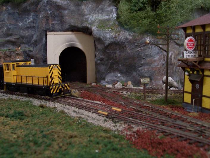

For old rock formations I add a coat of house paint or ground goop to look like a little soil in places. For new rock cut. I paint straight on the foam. That does not smooth out any of the details of carving. My best sample so far.
