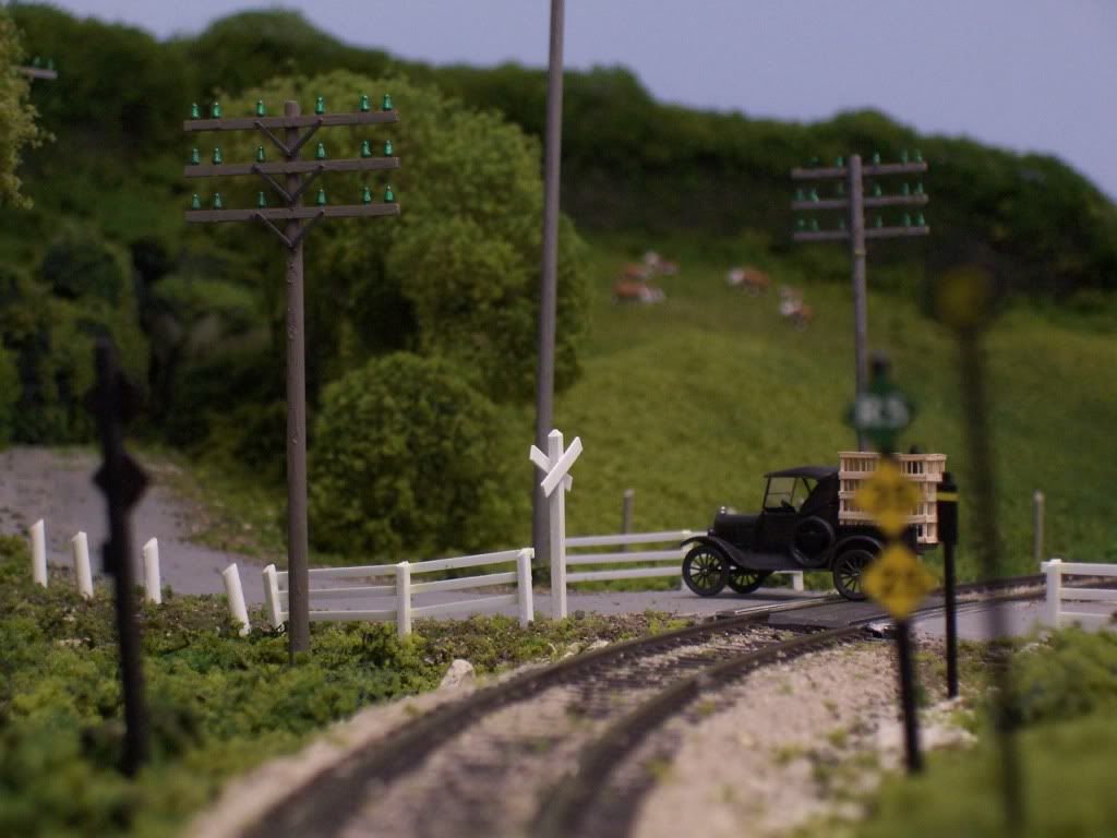

Once ground cover is applied, it easily hides the underlying plaster, without using too much material, and where the stain shows through, it doesn’t look at all out of place:

Wayne I love that disappearing road [Y]
Mike
Thanks for your kind words, Mike. That photo pretty-much gives away the whole ruse,[:-^] but it doesn’t look too bad from this angle…
Or even from the opposite direction, up on the hill, where the cows are in the previous photo…
