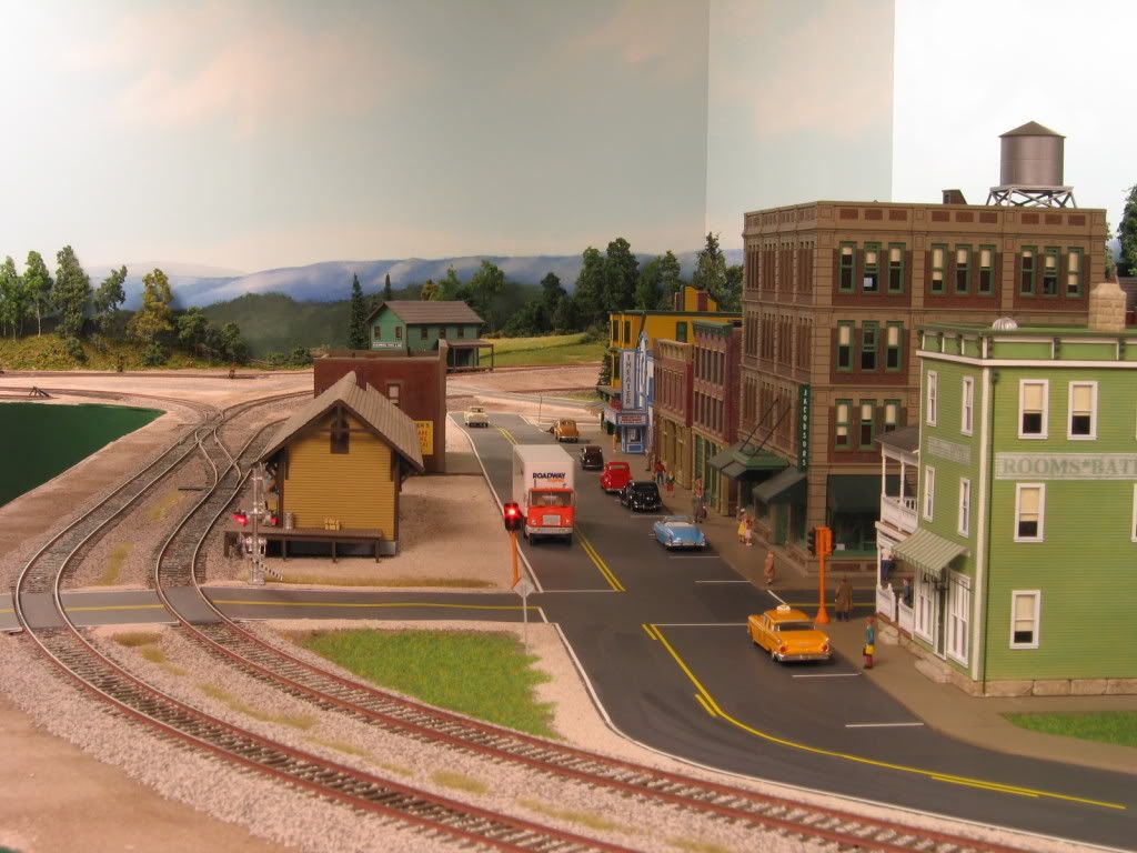

Here’s a construction pic. Everything is operational, but without painting and ballast it doesn’t look very good: Compare the unpainted crossovers, to the painted and ballasted track in the foreground.
Here’s the same area after track weathering and ballast:
If one’s goal is to improve the look of the bare metal rails to make them appear more realistic, how far does one wish to go? It is open-ended, itsn’t it? For those of us who opt to hand-paint using a brush, I won’t argue that it takes a lot longer than running upstairs, out the back door while shaking your spray can vigorously, and then spraying the item(s) for a quick paint job…and an effective one to be clear. It is just that one of the improvements you can make is also to the ties and the adjacent ballast nearest the rail foot, and that is bleed-down of the rust and grime. Painting using a spray method won’t be much faster if you do it finely enough to get just the right amount of bleed-down, except perhaps with a very steady hand and a fine airbrush…but I would challenge anyone to say an airbrush doing that fine detail would be considerably faster than dipping my brush and running the tip along the rails.
Here is what painted rails should look like if they are to compare favourably with images of the real thing.
