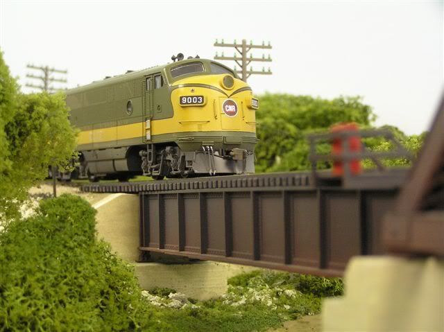

Here’s an example of what I said earlier about painting the normally unseen side of the rails -
As viewed from the aisle:
The same area, as viewed from the layout:
Of course, with the camera on the layout, it’s usually difficult to compose the shot. Luckily, with digital cameras, multiple attempts are free, and sometimes you can get pretty good results:
