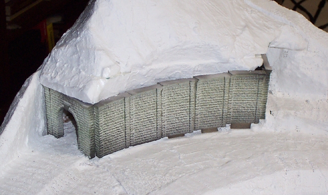

Here’s another method, if you’re like me and don’t want to do more work than necessary.
tunnel WIP
These are N scale WS single portals and retaining wall as a WIP.
  1. Spray (air brush) base color, I used dark ghost gray acryl , IIRC
  2. To show the accumulation of dirt near the base and lessening on the way up, air brush your “dirt” color, I just used a flat black, shooting at an angle from below. This feathers the “dirt” and since it can’t get into the mortar lines, it gives the illusion of mortar without any extra work,
Since my layout will always be viewed from above or level, the illusion works.
  1. The same can be done to simulate old steam residue.
It’s all about the illusion.
