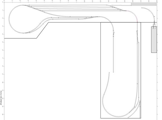

My dimensions are bit different than yours, but I’m also in HO and this is what I ended up doing.
(Yeah, I know the tracks don’t connect, but this is for planning purposes only.) The vertical rectangle at the bottom is my original Phase 1 layout, 5 feet by 12 feet. The horizontal part at the top is Phase 2, 19 feet long by 2 1/2 wide, with a bubble at the left side for the loop.
I wanted something like staging, but I don’t have the space for hidden tracks, and I didn’t want to go with a helix. So, I built the 4-track, double-ended staging yard at the top. This could be hidden, if desired, but I chose to leave it open. I have a number of tall buildings that will go in front of the yard, partially hiding it from view.
Any of the tracks can function as either storage or through tracks. The front one will have a passenger station and platforms. There is a reverse loop shown in the upper left, and the original Phase 1 section has another reverse loop which I didn’t bother to diagram. The loops face in opposite directions, so I can turn a train and bring it into the big yard from either direction.
Here’s one more shot.
