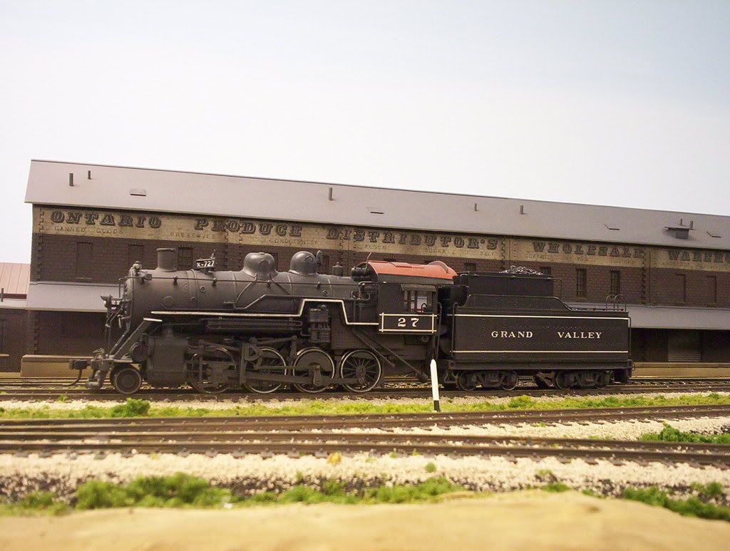

This locomotive cab and tender was lettered and striped using dry transfers as a masking device:
First, the cab and tender were painted white, then dry transfer alphabet sets were used to create the roadname and numbers. This was followed by the application of dry transfer striping of a suitable width. The dry transfers should not be burnished after application, and it doesn’t matter what colour they are , as they’re used only as a masking device. Next, the cab and tender are painted in their normal colours (I used Floquil paint). As soon as the paint was dry to the touch (I cleaned the airbrush, then proceeded), I daubed at the lettering and stripes with the sticky side of a bit of masking tape, lifting the dry transfers and revealing the white paint beneath. Replace the tape as it becomes covered, until all of the dry transfer material has been removed. As with masking tape, there may be some areas that will require touch-up - use an appropriately-sized brush to do this work. The running board edges, incidentally, were done with a brush.</
