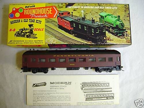

These are the best for you, probably. I have 2 sets of these, but even so, they do not fit terribly well even around 18 inch radii. I found the coupler bar on the truck swings and hits the stairs just a bit, and enough to derail the car at times. I have my doubts about the 15 inch radii.
This photo is from a current eBay listing. The seller is listing them one at a time. The guy started the auction at $10 per car. I wouldn’t pay much more than that opening price. I got my set of 4 (new) from another eBay seller for $40. It is best to get them as a set so you get all the proper cars.
These sets keep popping up on ebay and online stores.

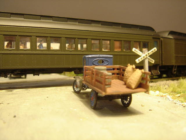

How about something like this?
This one is by Pocher. Model Power made a very similar car. They are 48 feet long. Boston commuters were riding in very similar cars as late as the 1950’s, although the B&M cars that I remember were all longer, say 60 foot.
Here is a pair of them behind a IHC Mogul.
