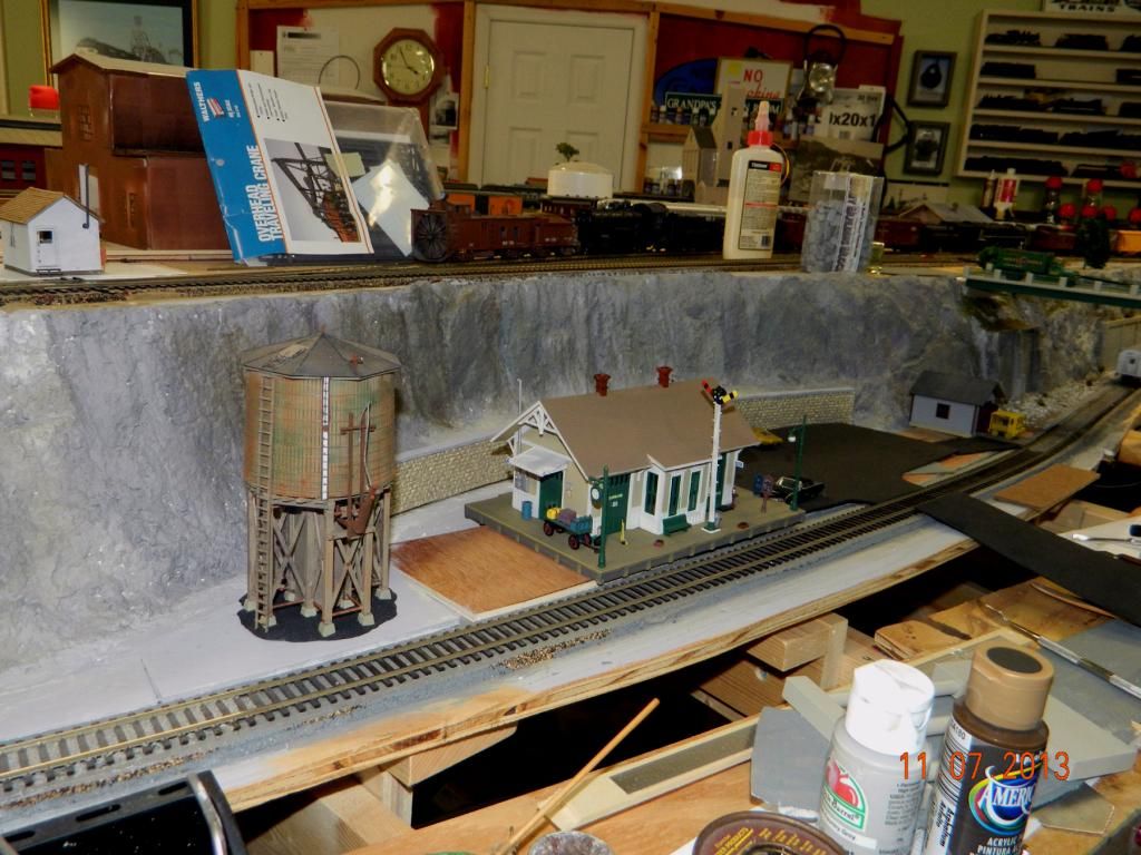

Sorry if this is a dumb question, but something looks off to me in the photo. Are all the buildings in the same scale? The house in the back and the car dealer seem larger than the town buildings.
BTW the station doesn’t have to be along straight track. Having a station along a curve isn’t / wasn’t uncommon. In this case, it would allow the station to ‘breathe’ a little more, it wouldn’t look as squeezed in.
I think there is a difference in terminology. The platform would extend all the way to the track. In your case the platform is wood. So the wood would extend all the way to what was described as the “curb”. You wouldn’t have a wood platform then a gravel area in between. Too much of a tripping hazard and it would make it difficult to roll baggage and express carts up alongside the train.
If it were my scene I would use basswood to extend the platform to within 5’ 6" - 6’ of the center line of the track, so its one smooth planked surface all the way from the depot building to the edge of the track.
I think that’s due to my using a fairly wide angle lens for the photo…, great for showing everything, bad for keeping things in correct perspective. I’m going to reshoot it today, one will be from almost overhead looking down, and post them in this thread.

What it currently looks like…

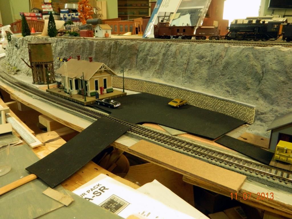

I have the same station on my layout and I put a 1/4" plywood sheet under it which is just about right. I used black sheet foam for the parking lot and road coming across the tracks (mine is sandwiched between the tracks and a vertical rock wall.). It just needs some weathering to tone down the black black asphalt (it isn’t new blacktop). This scene isn’t finished but is staged for the final layout.
