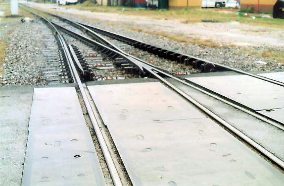

Usually, paved-area trackage that includes turnouts is low-speed - both trackage and pavement. The in-pavement rail may be standard or girder (integral flangeway) type - and will always be a little bit above the pavement. The switch point area can be cofferdammed off, then covered with “steel” (painted plastic or card stock) plates. The plate between the points will move with them.

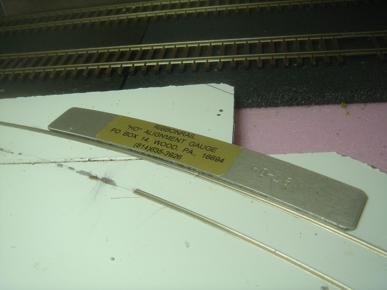

I’ve also used the Proto87 girder rail, and their cobblestone plastic sheets for the roads. I really like the way it looks, but there’s a significant learning curve, and I still have far too many derailments on it to consider the trackwork I’ve done there to be reliable.
For those who are curious about Proto87, this is an early shot of how I used a Ribbon-Rail track gauge to align two sections of 18-inch radius curved rail.

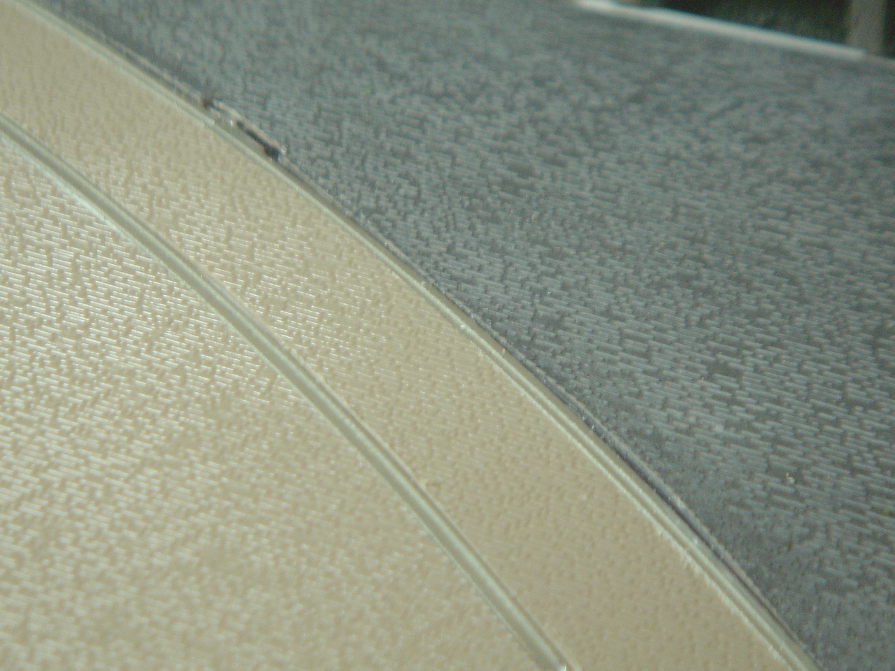

Here’s a quick test I did using black craft foam with some gray paint sponged on. The foam is flexible enough to move with the points. It’s easy to make patches and large cracks in the foam. Just tear the foam. But I’ve never been able to come up with a way to model small cracks in it. I tried crackle finish but that didn’t work.
