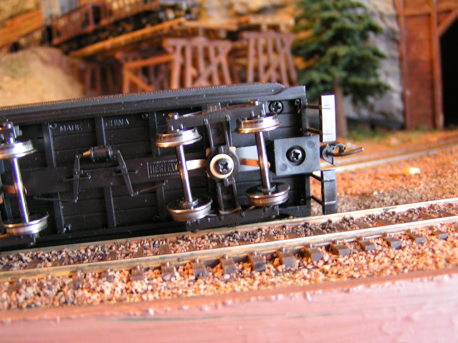

  • Install electrical pickups on the tender(not really that hard). Review the following web site for info: http://www.55n3.org/cars/tender_wipers/
