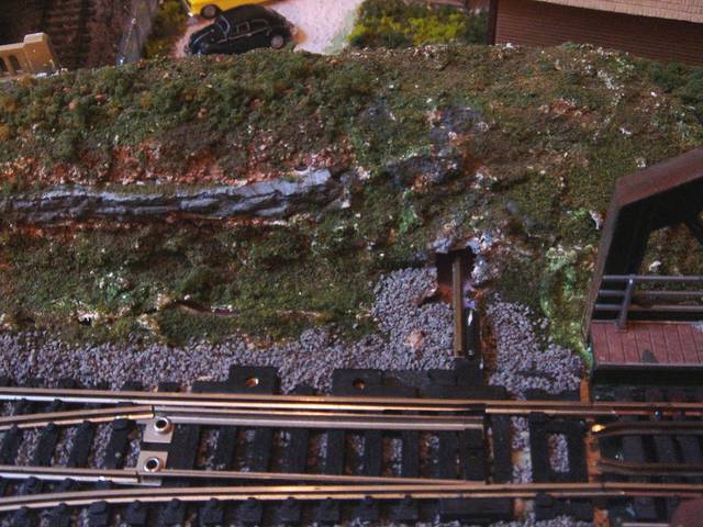

I have a lot of Atlas turnouts and switch machines, and I never have any trouble with them. They must be mounted flat and level. It is very easy to offset them from the track with some kind of extension on the throwbar.
Here, you can see the throwbar leading to an Atlas machine inside a scenic cover.
There are two Atlas machines in this picture. One is beneath a bunch of greenery, and the other is hidden inside the building.
The one in the foreground is directly attached to the turnout, as designed. These are Code 100, and the switch machines are much larger than the Code 83 models, so I have done my best to hide them.
