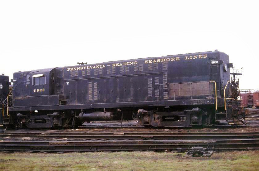

A photo of your Baldwin AS-16 would be helpful.
PRSL AS16
It looks like the numbers are the same as (or similar too) contemporary PRR numbers.
You might have to mix and match from a couple of sets to do what you want.
Eric

Interesting that the photo Eric posted is of 6022. The last 6 AS16’s that the PRSL had, 6022-6027, are different than the others in a very subtle way.
They were 6 units canceled by the Reading - so look at the cab roof above the side windows. Good old Reading drip rails!
–Randy

Hi Bill, I found the photo by googling “PRSL AS-16.” It was in the first few photos that came up. It’s from the American-Rails.com site. Eric
I found the same picture on rrpicturearchives.net and the caption says it was in Camden. The data give in 1976, so it was probably stored dead. There is another picture in the same set a year later that has it in Ft Wayne Indiana, with a bunch of the hood doors open, possibly being dismantled or cannibalized for parts.
Indeed the Camden shot is from the dead line. There’s also a picture of 6025 in Camden along with a bunch of E-L RS-3s and other locos.
Here’s their whole collection of PRSL AS16’s
http://www.rrpicturearchives.net/locolist.aspx?id=PRSL&mid=1133
–Randy
I jsut realized the picture I THOUGHT was the same as the one Eric posted isn’t - his is 6022 and the one I found is 6024, but the composition is almsot exactly the same. In Eric’s picture, there is another AS16 behind it. In the picture of 6024, it’s coupled ahead of GP38 #2000.
–Randy
