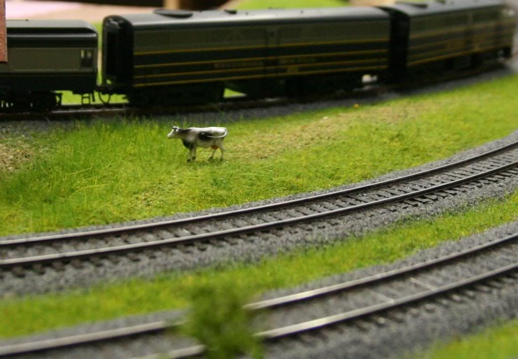

I’ve been using a lot of static grass in the mountain meadow area that I am working on and mixing it up a good bit to get different effects. My mainstay has been Noch 2-6mm blend. It goes down nicely and looks tall enough for what I am looking for. Sometimes I’ll mix in some 2mm Scenic Express grass just to thicken it up or add some other grasses and flowers to give it some variety.
For the tallest stands I am using Noch 12mm static grass. It is not as easy to put down by itself and it is a bit plain looking without highlights so I mix it with the 2-6mm blend. It is nowhere near as tall as the Illinois grass I think you are talking about, but I think it is about as tall as you can get with static grass. The cow in the photo is approaching a patch of it just to give you an idea.
One thing that helps to get the longer grasses to stand up is to first put down some sort of ground flock. I brush a 50/50 white glue/water mix on top of the flock and let it soak in. Then apply the static grass. This gives something for the static grass to bite into. Another thing that helps is to make sure you don’t hold the static applicator too close because the long grass will just mat up on the mesh if it is attracted to the layout surface too much. Hold the applicator back a bit though and the grass will fall right out.
