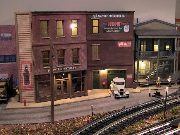

I just took this with only track lights at half brightness
I use 10 second delay, set for “tungsten” which I guess takes some of the red out and then to my “custom color” (a setting on a Canon SD750)
there are many times when I will still need to edit it to get the color just right
Good shot Ray, I particularly like the effect of the porch light and the bracket light between the two doors. Very realistic looking.

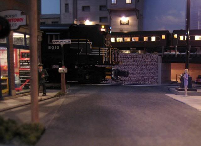

This was also taken with the Canon SD750 in manual mode with no special settings and no editing. This is the actual original.
No flash and taken using the timer. It is unusual however for something this dark not to need editing, at least for me.

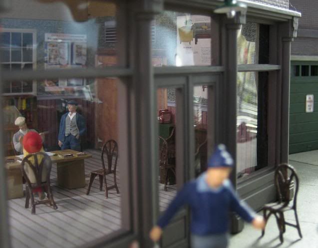

I was able to get good focus on the interior but had to sacrifice the closer area to do it
