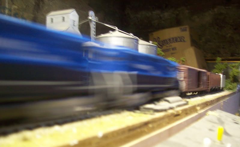

Got a question for the photographers,been to a few layouts with my new digital camera.I have noticed in some of the pictures that the moving trains blur alittle bit.I have the camera set on action but don’t know why some are excellant and some blur.Could it be the lighting or maybe I zoom in to close,any help would be great.

Most often it’s the lighting. If it’s too dim, the camera will set the aperture low (wider lens opening), creating a short depth of field, and set the exposure for longer, so that any movements, including moving trains and camera shake, will show up on the photo as blur.
This may sound obvious, but if you’re photographing trains on your own of a friend’s layout (only photographing trains, not in the middle of operating trains), than you can just pose the train where you want the photo. That way, you won’t get any blur, as nothing will be moving. Here’s an example, taken on my HO scale layout.
If stopping the trains aren’t an option, then you can use a pan shot. This involves moving the camera at the same speed as the train while taking the photo. This can be acomplished either by turning the camera in place (hence the name “pan” shot) or by moving the camera at the same speed at the train as if on a long pole attached to the train. The train will look like it’s stopped, and the scene will be blurred. This may sound like a bad compromise, but a properly taken pan shot will often look better than a regular shot with everything frozen. Here are two examples of a pan shot. The first shot is an “on the long pole” shot, with the whole train stopped, while the second is turning the camera, giving us just the center of the frame frozen, and the edges blurred. Both were taken on the modular O scale layout of the Southern New England Model Railroad Club at the Springfield, MA train show.

The bottom picture is kinda what I have gotten.I will try using a flash also,will have to play around with it,thanks for all the info.
