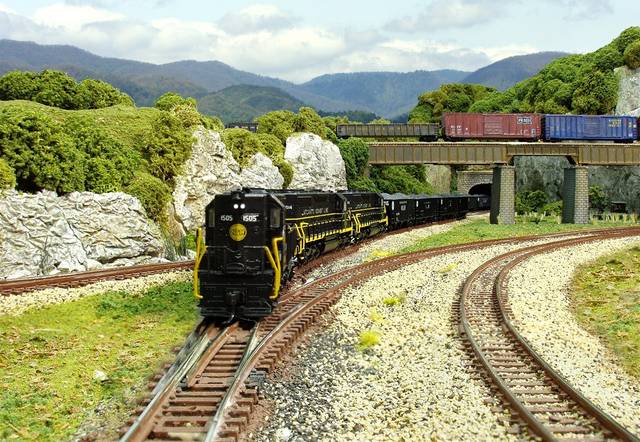

It looks pretty similar to my Canon S3, perhaps a lot more sophisticated, but generally, the principles are the same.
I set my ISO to it’s lowest setting, and put the selector to the setting that controls the exposure time. I also hit the Macro button, to make sure it’s thinking up close. Depending on the situation, I’ll set the exposure time anywhere from 3 to 8 seconds (obviously, you need some sort of tripod or other stabilizer) and I use the :10 self timer to eliminate any “finger on the button” wobble. The low lighting and close focal length usually forces the f-stop to its smallest (highest number) as well.
Once that’s all set, I change the one element that has nothing to do with the camera. The room lighting. My train room is lit with floods on a track light system. This allows me to direct the lighting onto the scene I’m shooting. These are controlled by dimmers, so I can drop the lighting back significantly to let the time exposure work its magic.
Finally, I have DCC, so I have the ability to control the headlights on the engine from a remote hand held, so I simply flash the lights on briefly, then off, to keep them from “burning in” too long during the exposure.
!(https://lh5.googleusercontent.com/_ERLF7TTPvmA/TRiUWFtEY9I/AAAAAAAAMOQ/-IL6ZW-z84I/s800/New Weeklies 096.jpg)
The combined effect is pretty good DOF from front to back, a full reading of color and textures, and very limited fuzzy edges.

So I use Combine ZP, which is an image processing software package for creating extended depth of field images. You take several shots of the EXACT same scene at different focus points. The software then combines them.
Here’s an N-scale shot I took using this software:
There is no way I’d be able to get my camera to take this shot itself on any setting.
