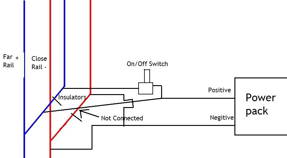

Well, Insulators insulate, meaning they block the flow of electricity to the rails they are connected to. When you place metal on the rails, you connect the circut and electricty flows to your engines. What you need to do is get a simple on/off switch and wire it up as in this scematic:
If you want your engines to move, turn the switch on, if you want them to not move, turn the switch off.
If you need clarification on what is connected and what is not, post a reply.
