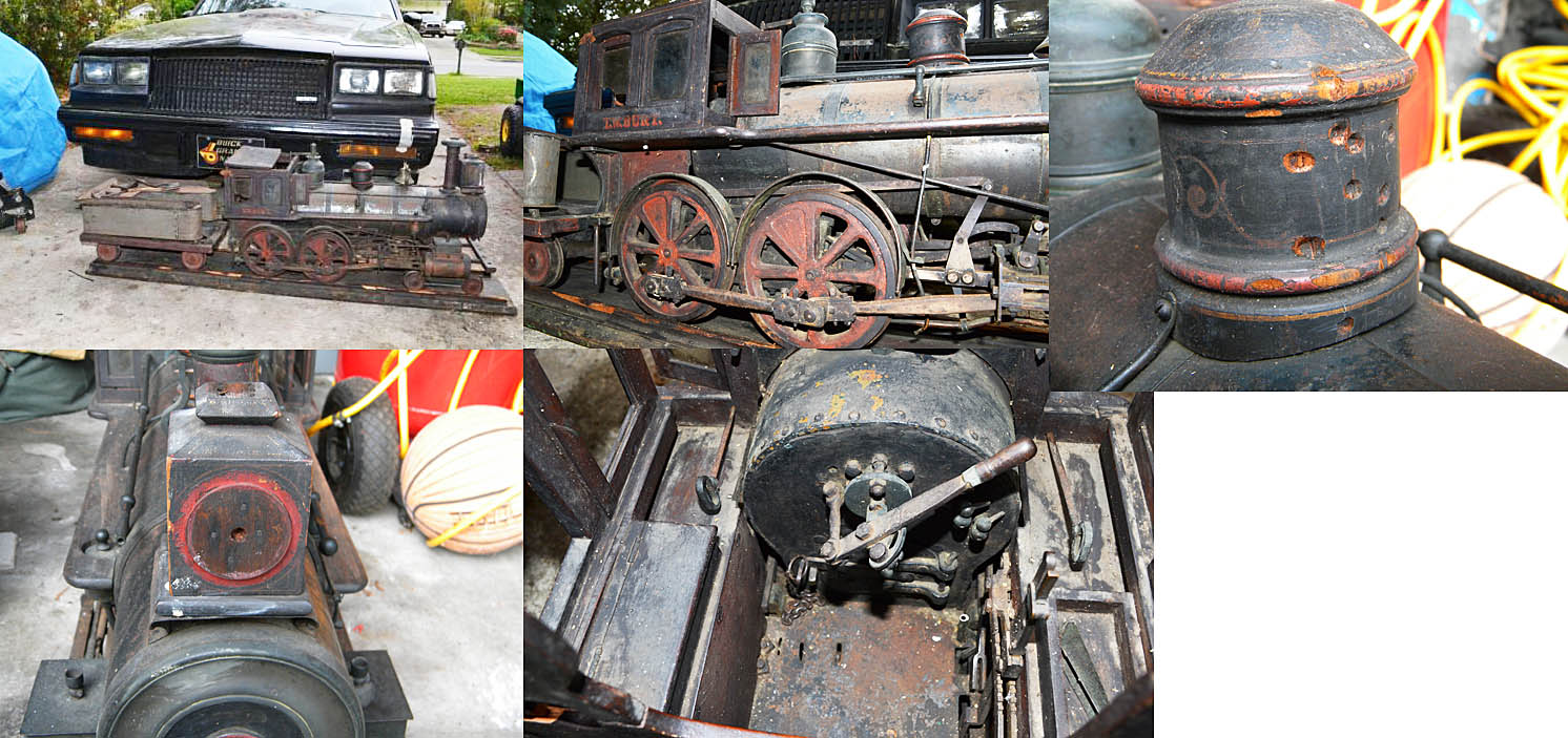

Please help to identify model 1870-90s steam locomotive. Made by Cagney or just an old hobby model?
Interesting locomotive. Can you measure the gauge (distance between the inside edges of the rail heads)?
Is it a Cagney? No; at least not a production locomotive. The details of the construction are a lot different, and it would appear to be smaller than a Class C, D or E by looking at your picture of it in front of the car.
Now, the McGarigle brothers (who actually produced the Cagney locos) built small live steam locos for park train use prior to the association w/ Cagney. Very little is known about those locomotives. However, I would still doubt that this is one of those engines.
It looks like the headlight and sand dome are wood… very unusual for what appears to be an operating live steam locomotive.
Sometimes it can be difficult to track down the history of a given locomotive. There were a lot more one-off models built way back when than most people would think. I have one that I’ve owned for 14 years, and still haven’t found any history on it.
It is a very nice model! Thanks for posting it, and hopefully someone can identify it. Let us know some dimensions when you get a chance.

Thank you James. As I remember, the gage, a dictance between rails is 7 inches. I think you right about Cagney. Even if it was that brand, they woudl probably place their stamp or some kind of indication on a boiler or somewhere else. I was looking for a name of T.W.Burt written on a side and apparantly that gentleman holds some patents from 1870s related to railroad.
James, I was also thinking about wooden parts of this locomotive. This is why pretty much I decided to obtain it. I love the decorative parts of models and those were good examples.
7" gauge is very close to scale for a 1/8th scale model of a standard gauge locomotive. I suspect that this model was built well before the present 7-1/4" & 7-1/2" gauges were established. At any rate, this is smaller than the McGarigle/Cagney gauges that I’m aware of.
