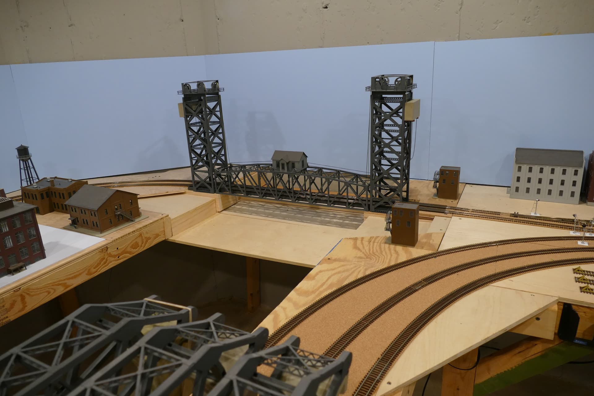

I really like the idea behind this thread, a photographic build sequence. At first, I thought that I could not participate except to offer kudos since most of my build sequences are photographed on the workbench. But while I was down fooling around my layout this afternoon, I got to thinking about some photos I took of my progress on the layout. So, here goes.
When I started building my newest layout back in 2018, I needed a space on my layout to display a scratchbuilt vertical lift bridge. I chose the following location where I could place a river with a bridge running over it to replicate the PRR vertical lift bridge over the South Branch of the Chicago River in downtown Chicago.
After I finished the initial frame work, I test fit the bridge on the base.
I then began the process of building the river bed (actually a controlled channel on the prototype) in the open space.
Once that was done, I began to paint the river bed and seal any openings to prevent leaks of the Envirotex Lite that I used to simulate water.
Lastly, I poured the water and finished the landscaping around the bridge area.
I was pretty pleased with the outcome.
