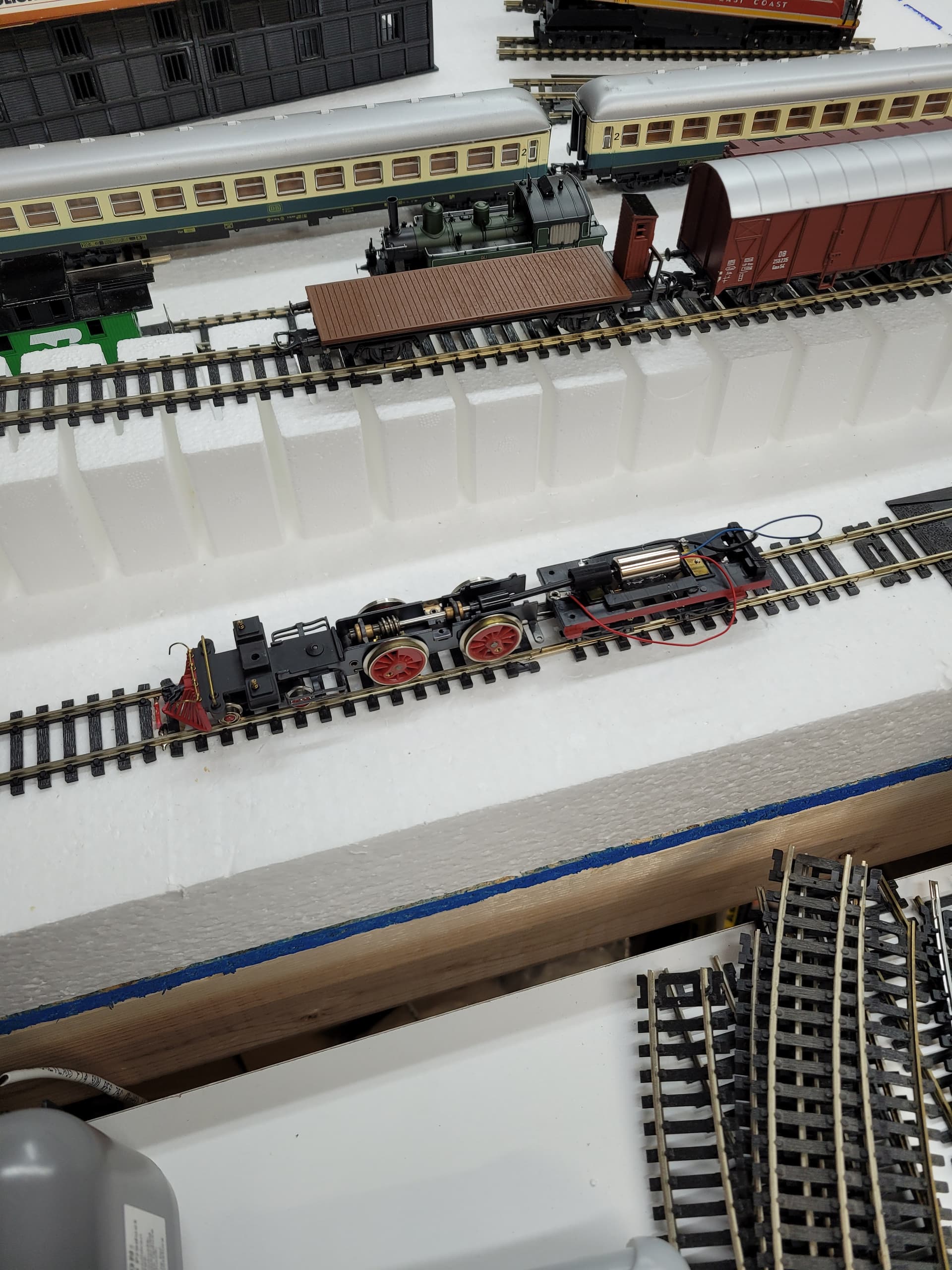

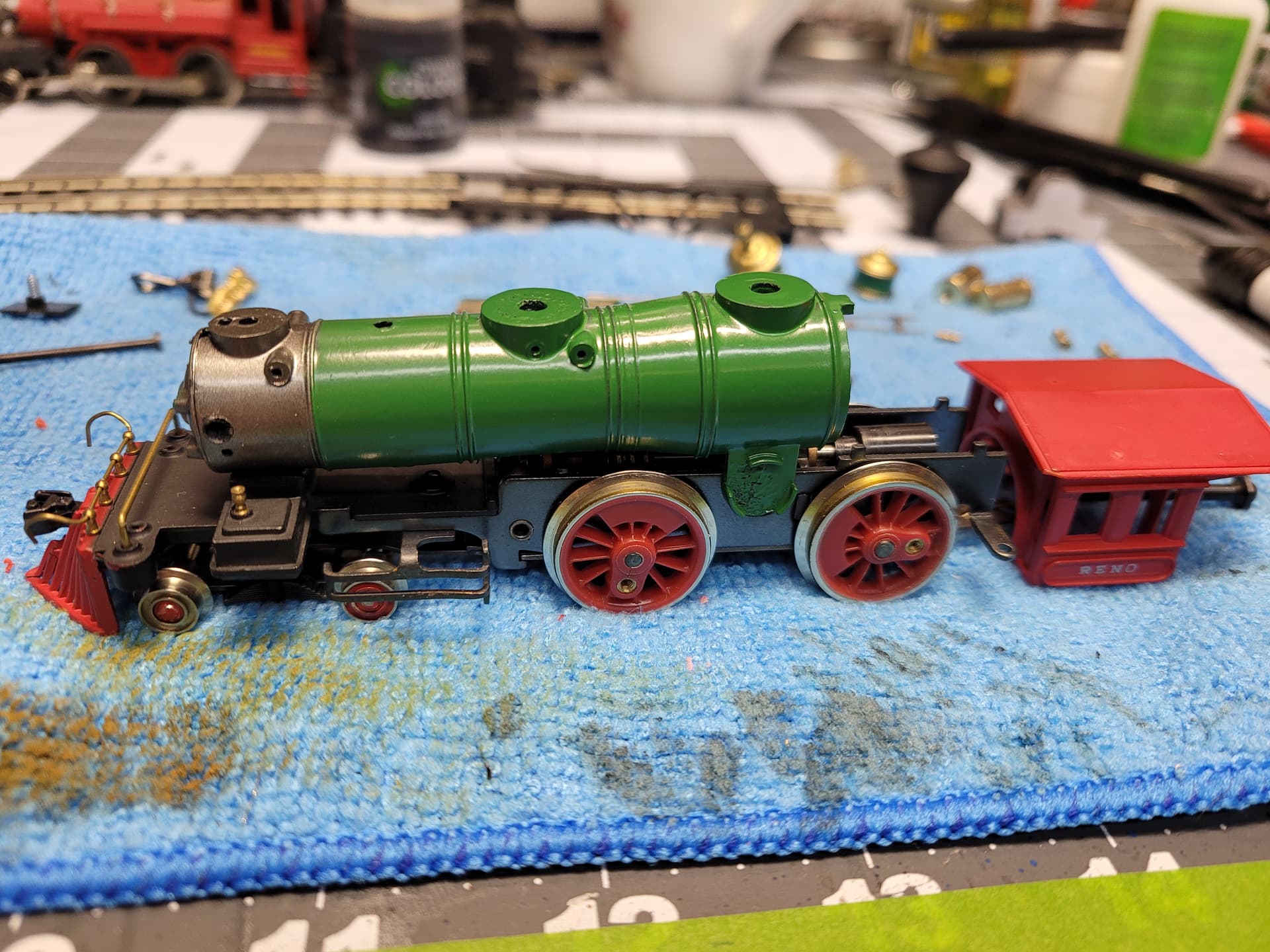

Just wanted to share some work I’ve been doing to this old 4-4-0. It was barely running when I got it and missing some detail parts. I decided since I wanted to have a beautiful 4-4-0 without having to dump $300 on a new toy looking one, I would go the stupid route and use this one lol. Here is the drivetrain so far. I designed a new motor mount for a 8mm coreless along with a new hex cup for the 1mm shaft. I botched everything back together for testing and it runs great, even without lube and weights! If anyone is interested in this project I will update it here as I go. I guess new users can only add one pic…odd.

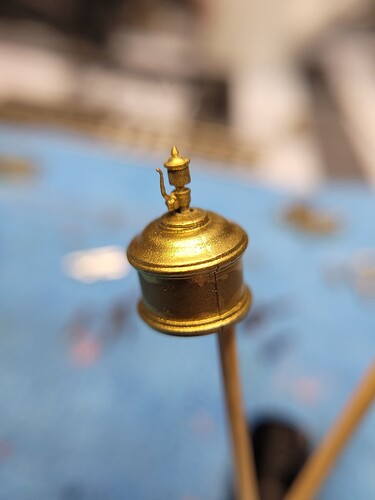

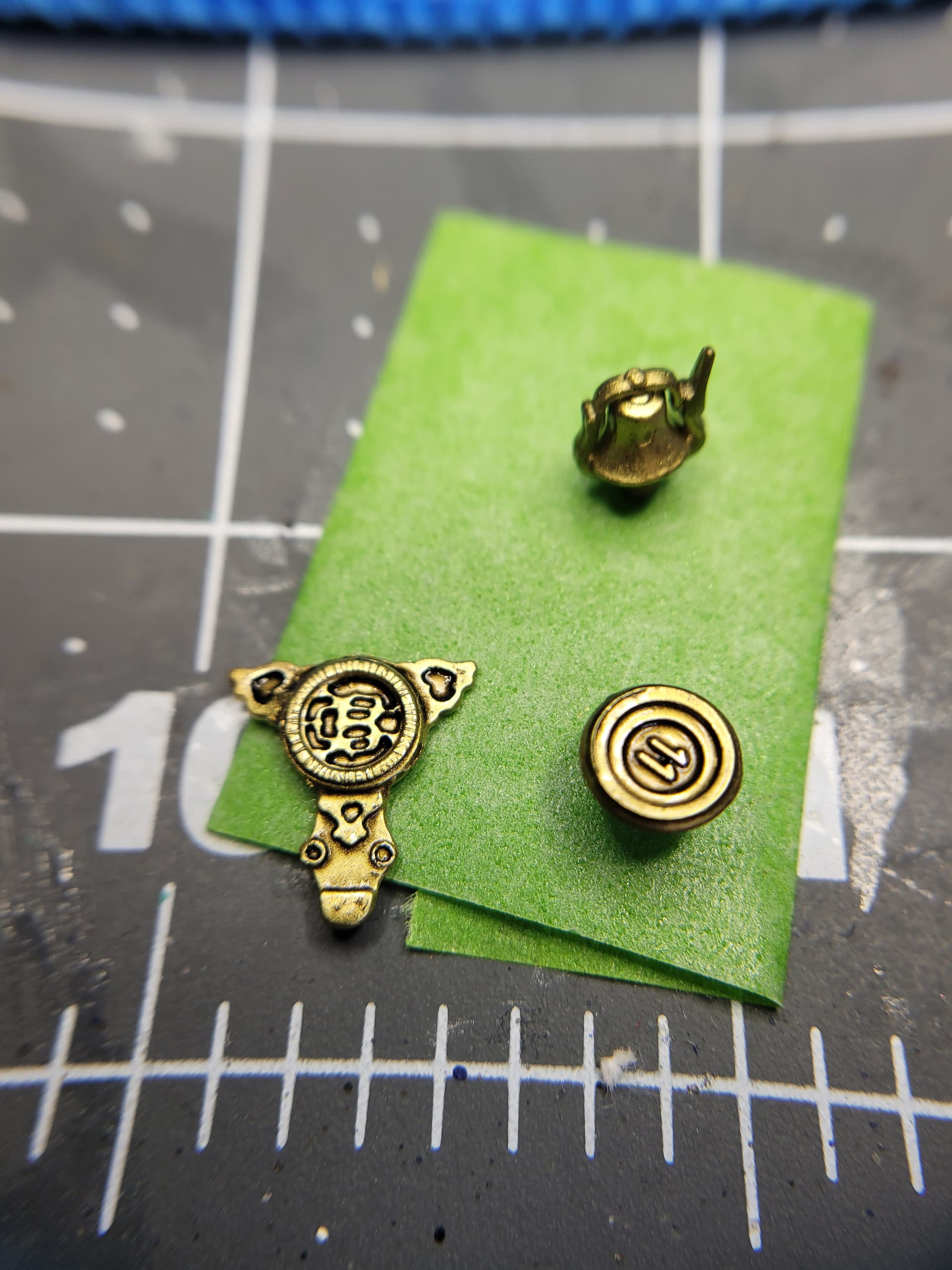

Working on these detail pieces while waiting for some parts to arrive. The metallic coating had pretty much flaked off and they looked haggard. I found some halfway decent metallic paint pens and have been playing around with them. A little top coat of some gloss nuln oil from Citadel and I think these parts look pretty good. I may give them a little dry brush with Retributor Armour which is kind of like a brassy gold from Citadel.

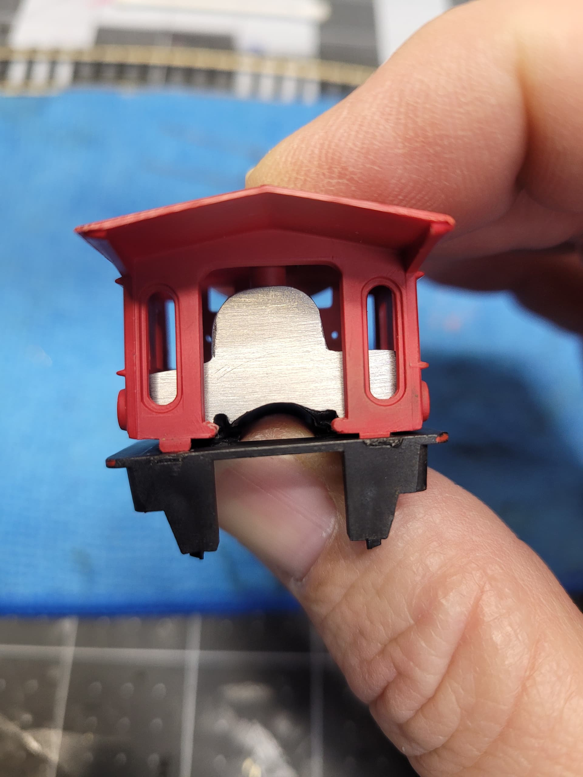

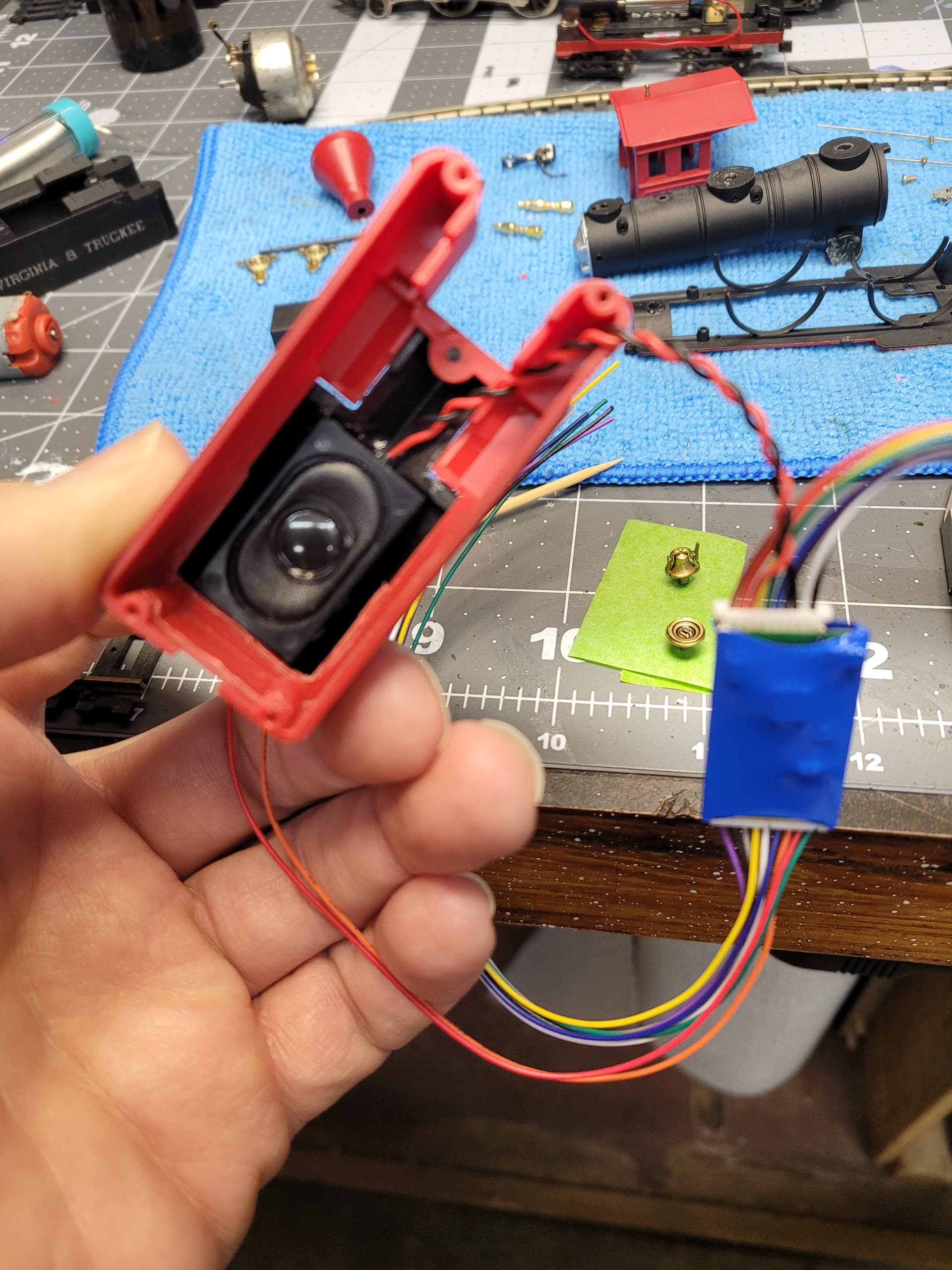

Shaping the weight to resemble a cab. I only have my filament printer set up since we moved to our new house, but soon I’ll set up my resin printers and make a firebox door and other details. I already have a flicker circuit with nano chip LEDs from Evan Designs. The Digitrax I ordered was a touch too big so I’ve ordered another thats suitable for N and HO…I’ll just stick this one in another locomotive :laughing:

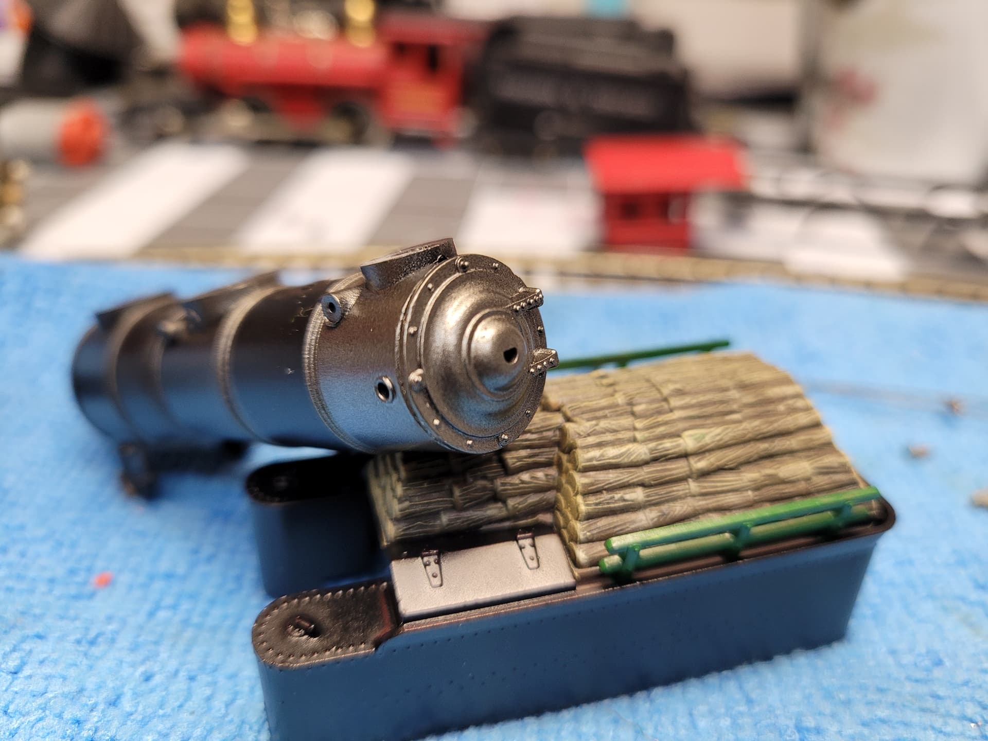

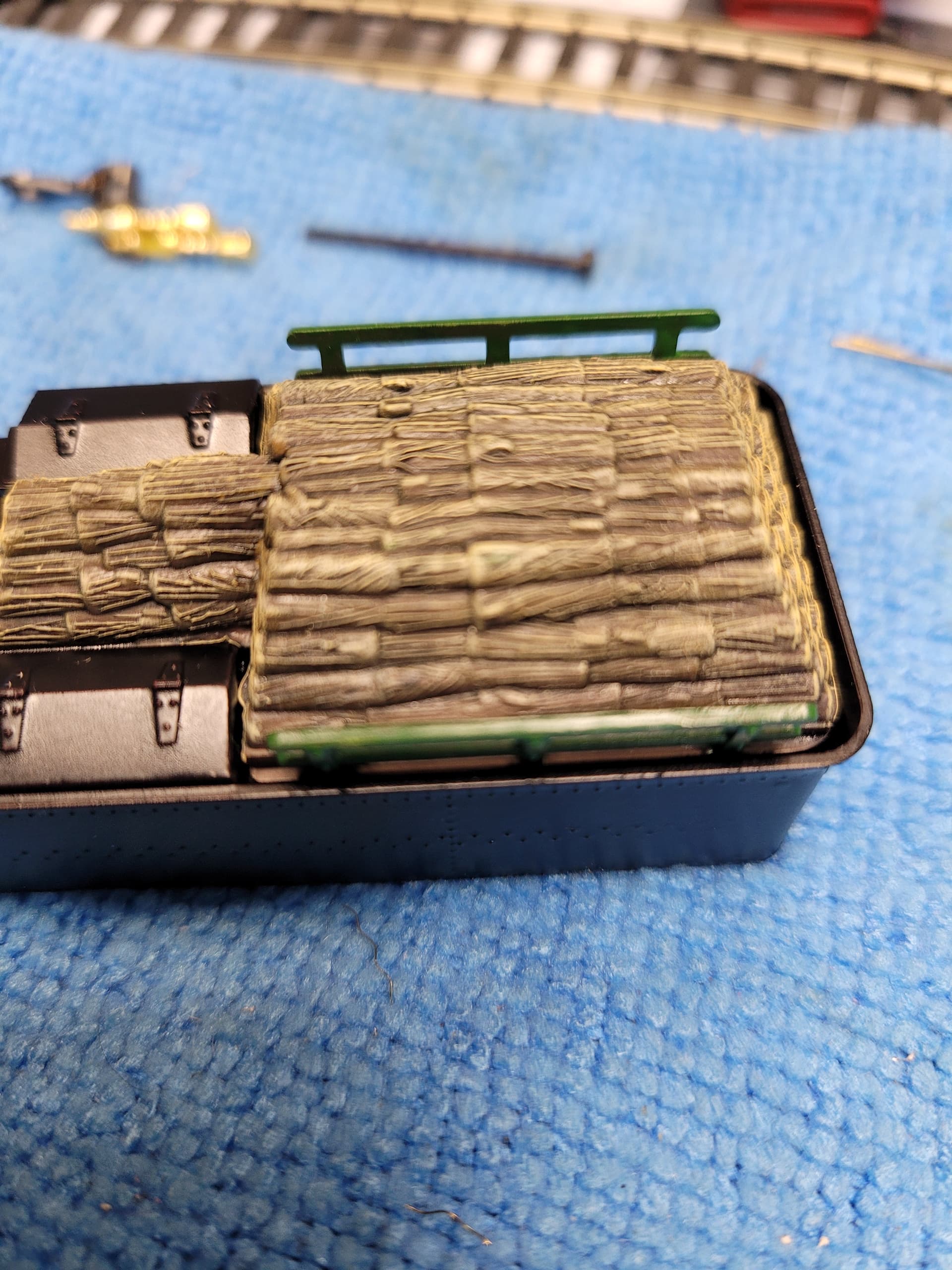

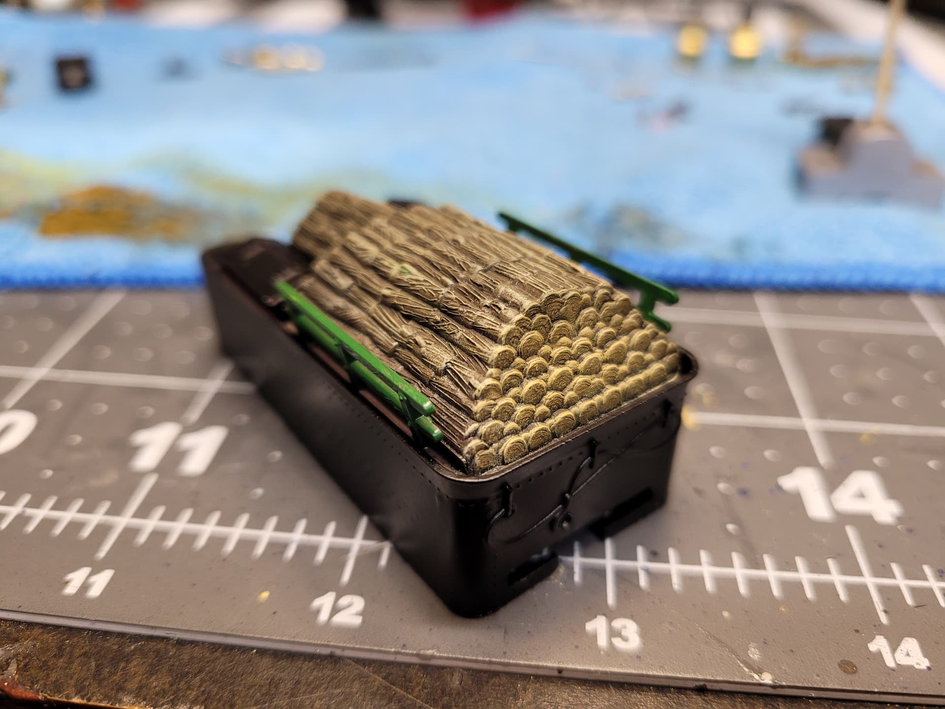

Still waiting on my smaller decoder so I decided to do something with the brown blob wood load that seems common on these trains…what do you think? Also tuned my airbrush a bit and greyed out the smoke box but decided its too cold to do the boiler or tender at the moment. My working marker lights from Tomar Industries came and these suckers are going to be fun :laughing:

Fantastic job on the wood load in the tender! VERY realistic!
Thank you for the kind words, turns out painting HO details is very similar to Warhammer 40K figures :laughing: They both require a big magnifying glass, lots of light and steadier hands than mine!

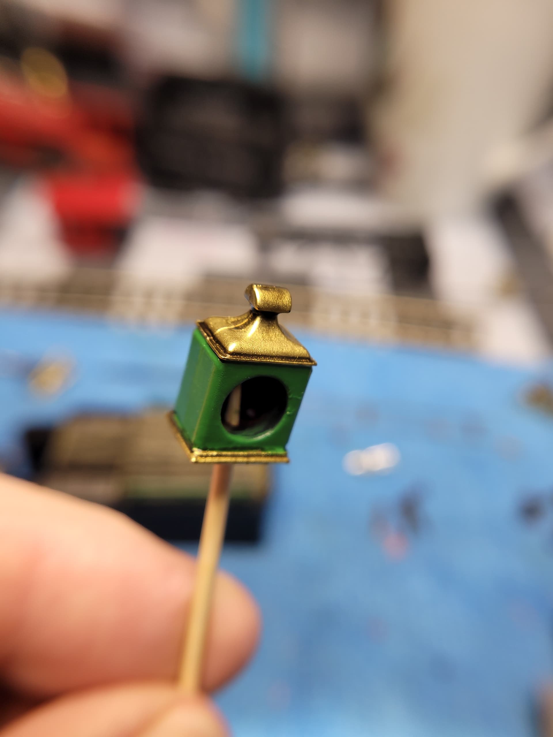

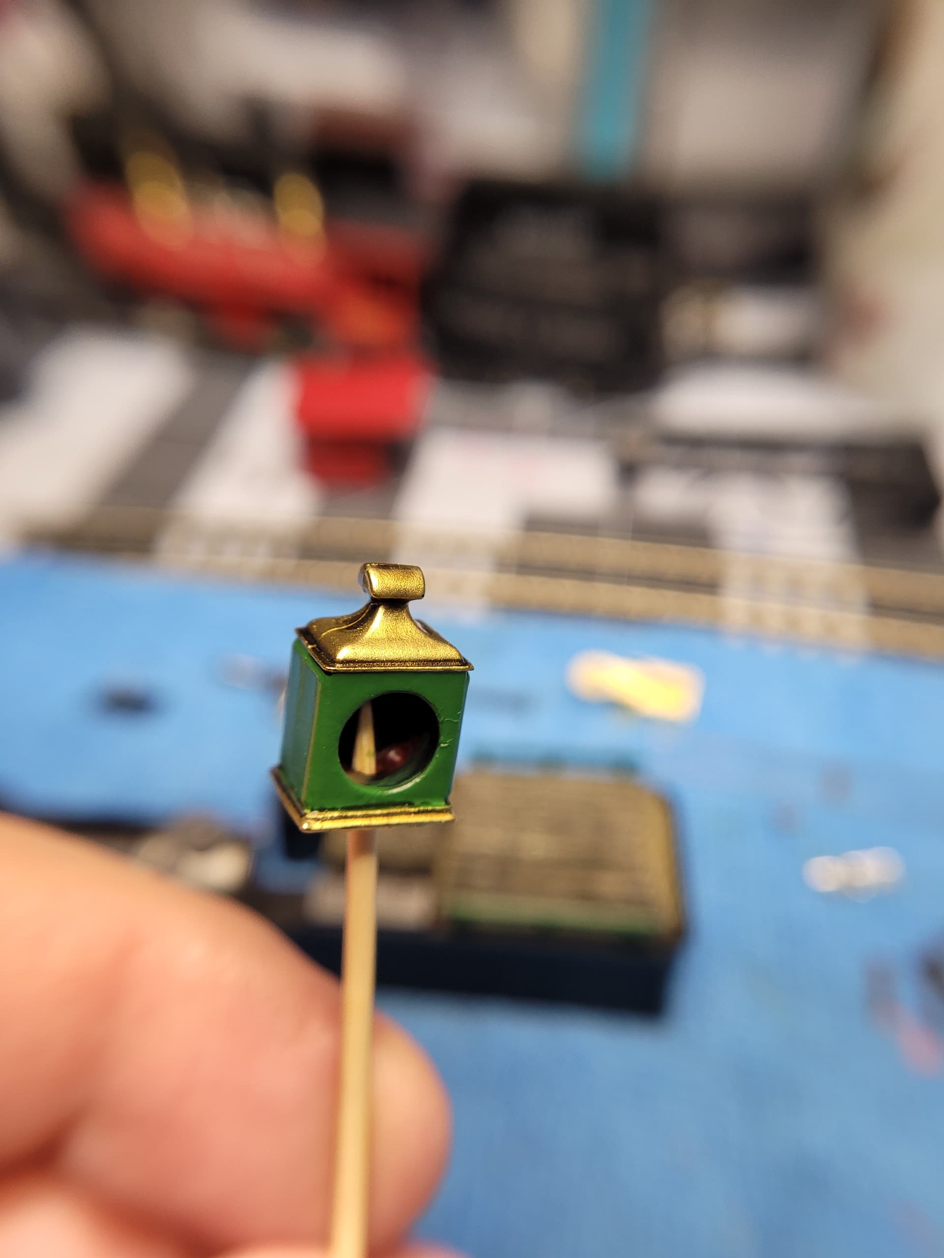

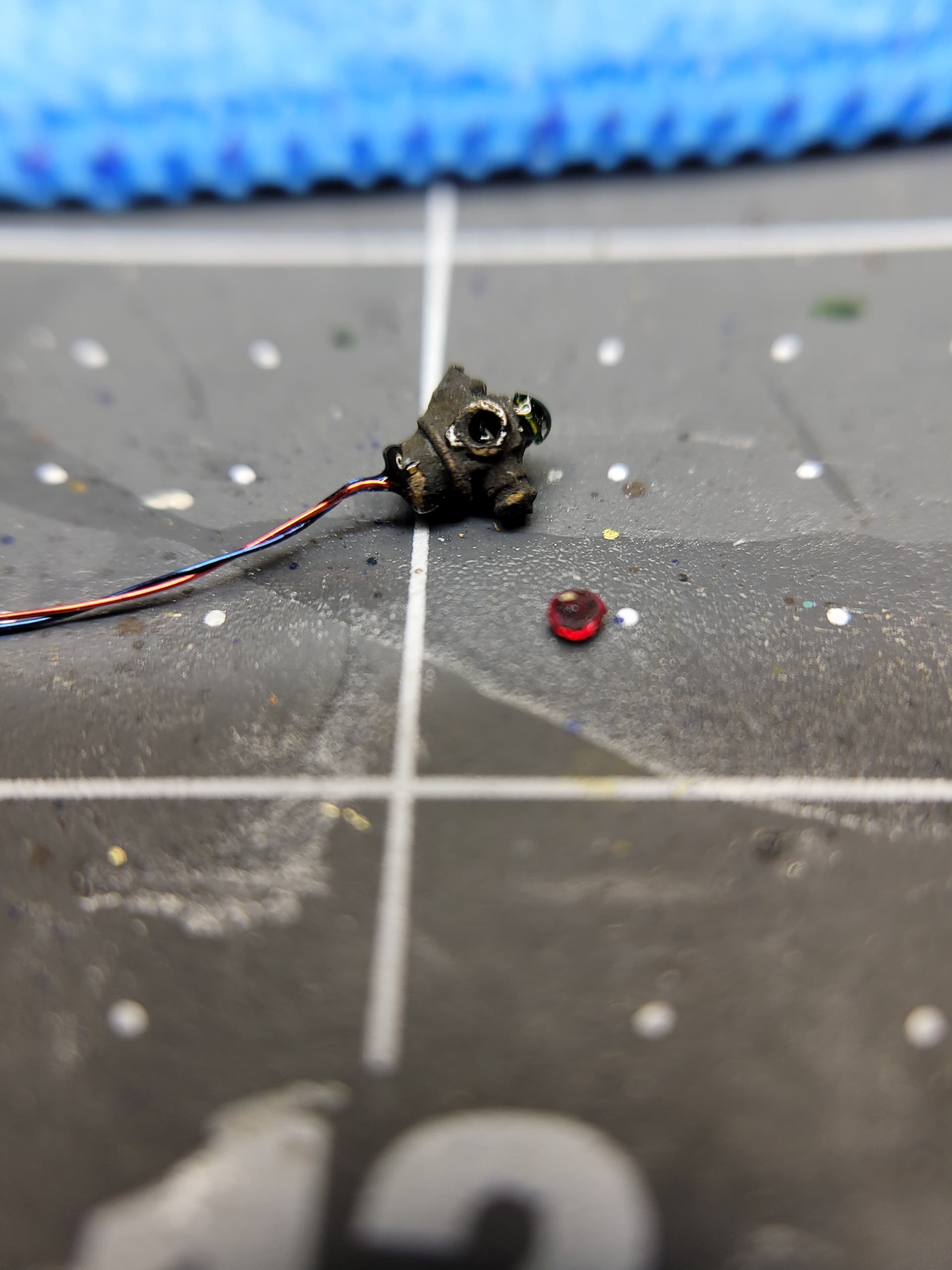

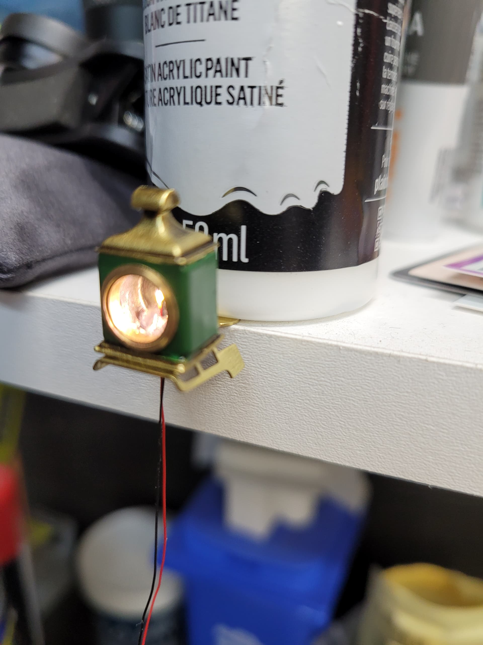

My Cal-Scale whistle just showed up, the origanal plastic one was broken off. Also got some finishing work done on the headlamp that I drilled for a pico size chip LED.
Hope I’m not over updating…here are some more pics, I’m done for today.

Have you thought about making a parabolic reflector for the back of that headlamp? It would be simple the way you’ve drilled it out, and add realism when the LED is off…
Great idea, I’m sure I have something laying around that would fit the bill! Thanks :blush:
